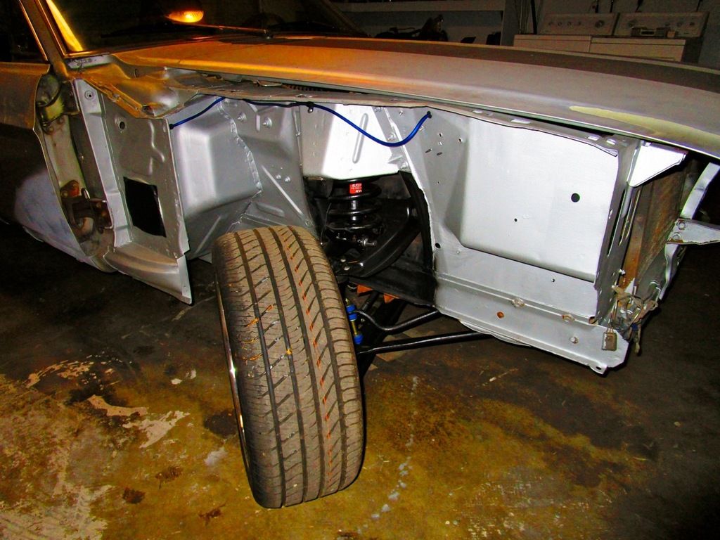

So the first thing that I did was pull off the front end and take it down to bare metal. I then prepped and painted with MasterSeries Silver.

As it sits, the car now has all-new front/rear suspension, brakes, steering, and power steering.
