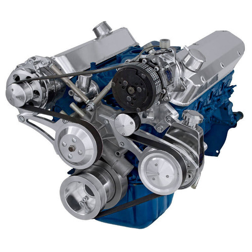

I am about to bash my head in to the wall with this temperature issue... So any help would be greatly appreciated. I am not running a crazy built engine to have these issues. Its a 65 mustang with a 351w stroked to a 408 with aluminum heads and converted to EFI holley sniper with a tremec TKO 5 spd and a 9 inch rear end 3:73. The car has AC and power steering.. The temperature creeps up to 226 at idle or if im driving around town or minor traffic. Once im on the freeway cruising 65+MPH it drops down to about 190ish.

im starting to think the pulleys are my issue my crank pulley and water pump pulley both measure 5-3/8. Is anyone else using the CVF racing pulley kit thats experiencing the same issues? I called them and they said they have never heard this issue. Again any help or knowledge shared would be appreciated as I am learning as I go.
