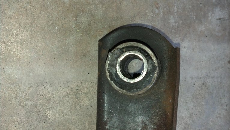

Welcome! I took on the project of making my Mustang driving more like a modern car and not riding like a dump truck that’s typical of a lot of modified suspensions. Lotta guts for someone not really up on suspensions. The key is understanding the shortfalls of these cars. The other is understanding there’s a excellent chance the suspension is pretty used up by the time we get them.
The two big design flaws are poor camber curve and lousy alignment specs. Luckily both of these can be addressed cheaply. Once taken care of and these become fun cars to drive. When I started, my car was a real white knuckle driver. One of the scariest drives is when I moved and had to drive it 150 miles on the highway. I could not be near another car for fear of hitting it.
The big wear item that will make these cars drive awful are worn lower control arm bushings. I’d recommend inspecting all the suspension components for wear. As 2nd66 mentioned adjustable struts. These serve two purposes. They will allow for more, much needed caster. The other probably more important is that they eliminate the rubber biscuits which will give erratic handling and braking. Lowering the upper control arms aka Arning and Shelby drop is pretty much a free modification outside the cost of a 17/32” drill bit. This modification makes a huge difference and gives that go cart feeling.
This was one of my lower control arms, no wonder it was so scary.
This was the other lower arm
