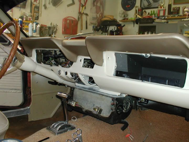

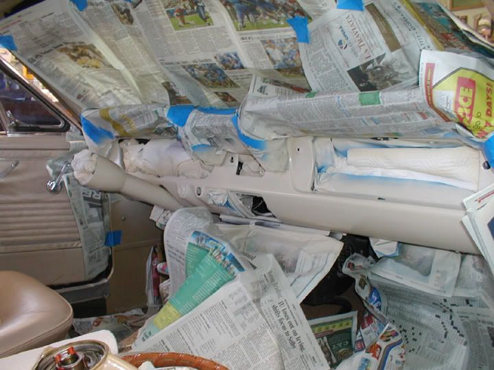

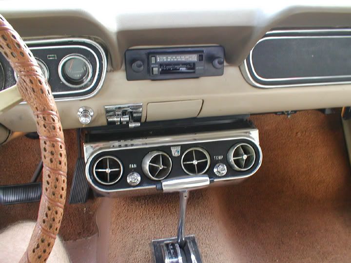

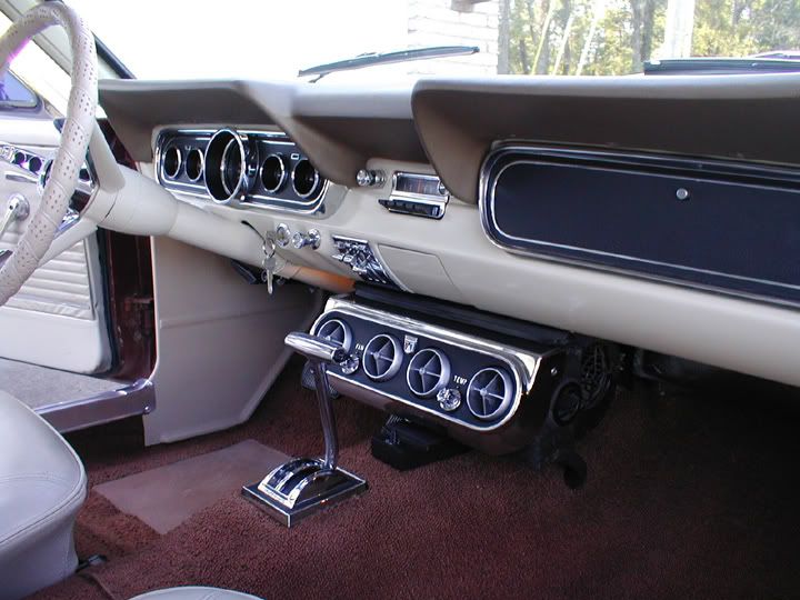

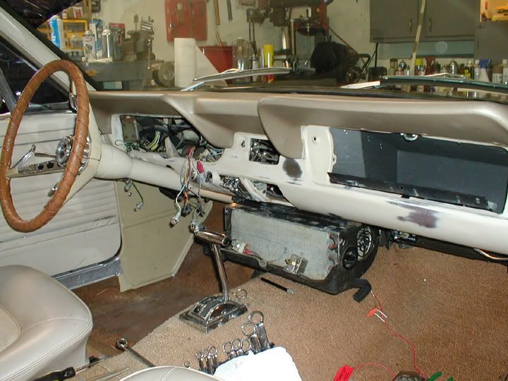

before and after pics of the wifes 66 interior. Over the past couple of weekends, I gutted the interior, repainted the dash, door and rear panels, redyed the carpet and replaced the cracked kick panels, gauge bezel, shifter bezel, and 20 year old steering wheel cover... I threw out the vintage 1980's cassette deck for an original 66 AM... luckily they didnt cut the dash for that cassette deck. They did enlongate the control knob holes a little, but nothing the original knobs couldn't cover... New door panels and armrests are coming soon.

Oh Yeah I forgot to mention , Thats an IPOD docking station under the AC in the last photo...I am debating whether to leave it there or put it in the glove box.
