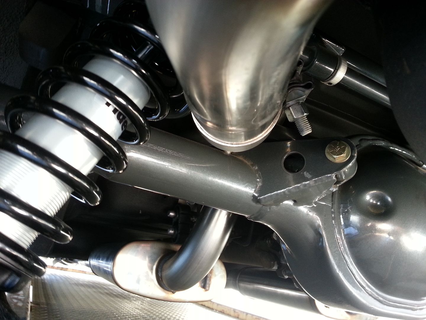

This project has been stalled for the last year or so but now it is nearing completion. Like many projects on a budget, things progress slowly. It is owned by our Marketing Manager Ben Bryce and was used to design our Triangulated 4-Link. Ben has owned the car for roughly 15 years and primarily just cruiesd it on weekends. Ben has absolutely zero experience autocrossing but is ready to get behind the wheel after watching the rest of the guys have their turn.

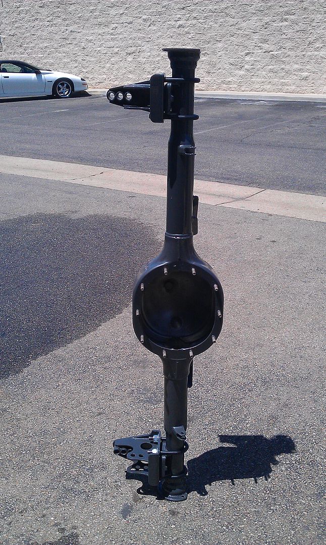

The stock 8" rearend getting freshened up. He used the bolt-on 4-Link brackets that come with the kit.
Once we were finished designing the Triangulated 4-Link all the pre-production parts were removed in favor of powdercoated production pieces. (No brakes just yet)
