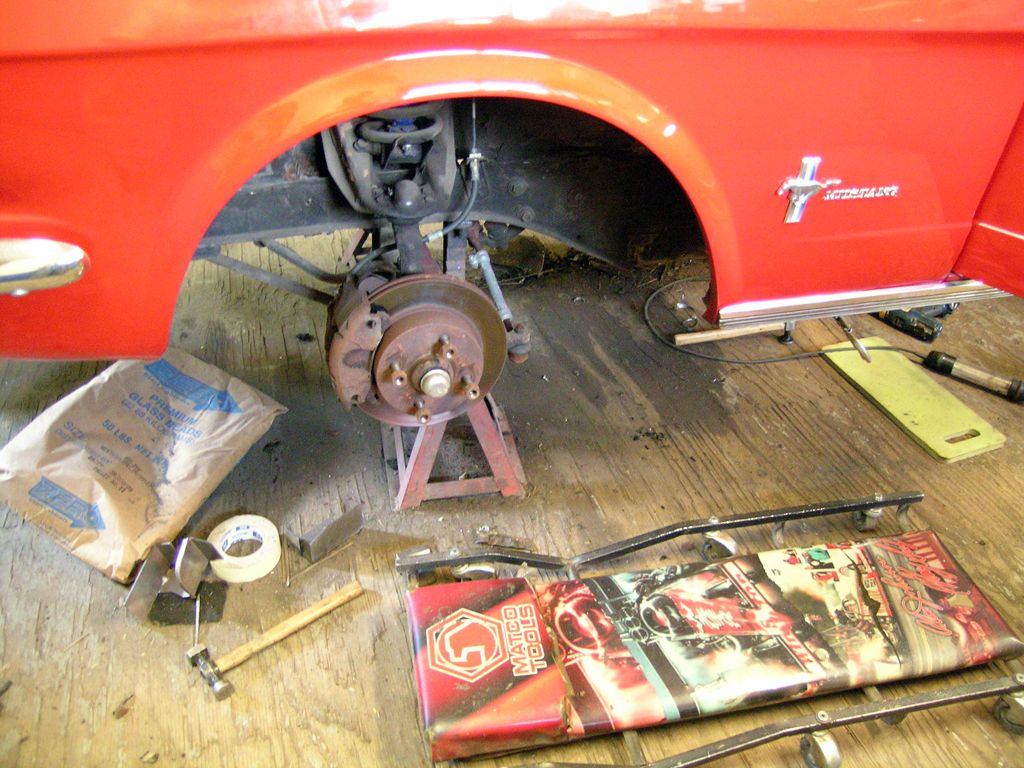

I put chocks disks on my 64 1/2 without the power booster and there is a huge difference in stopping power.

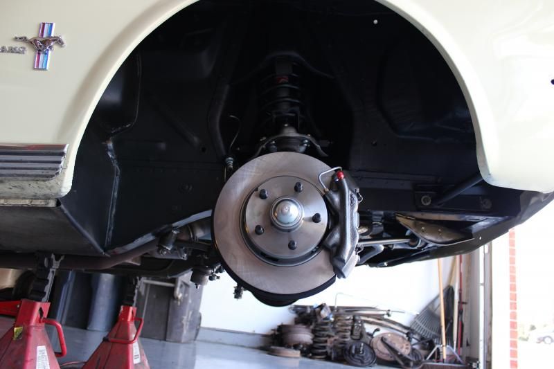

I have the Wilwood setup in the front, they work very well :) Can't comment on the CSRP setup, but the Wilwood discs upfront combined with the SSBC discs in the rear put up with my abuse.
This is the kit I used:
1969 FORD MUSTANG Wilwood Dynalite Pro Series Front Disc Brake Kits 140-11071 - Free Shipping on Orders Over $99 at Summit Racing
It's definitely overkill for your application if you're just going put put around town. DEFINITELY ditch the drums though in favor of discs, regardless of your driving style. Modern cars (and drivers) stop much faster than our old mustangs, 4 wheel drums simply don't keep up.
