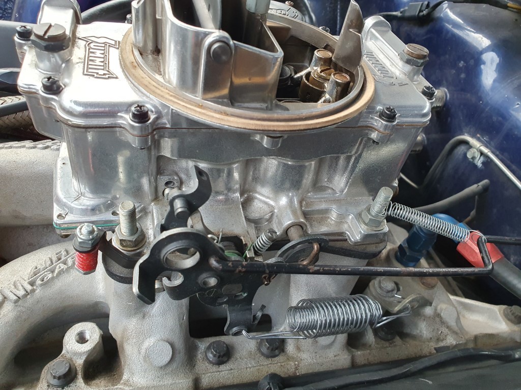

I think my fuel lines will work as long as the Edelbrock filter is 3/8
You might want to check the length of the carburetor studs in the intake. The M2008VS comes with a phenolic spacer & I remember when I changed my Edelbrock 1405 to the Summit carb the carb studs were too short.
Any idea what length studs you went to?
According to Summit the base spacer is .25in thick. I’ll assume the flange thickness is the same or similar to the Edelbrock.
I'm off to the garage later on today so I will take a vernier caliper with me & get the measurements.

I have the 2 1/4 inch studs in there. They maybe a bit long but it works for me.

My current studs have about 1/4in or less showing. So I’ll probably need longer studs. But not much.
I have an in-line Edelbrock filter which is -6 AN so it should screw right into the Summit line.

Carb ordered. Also got the ARP studs. And while I was ordering... ARP valve cover studs. Hopefully here this weekend. I think I'll need to short my fuel line if I want to keep my inline fuel filter. Right now there are four filters between the tank and the carb. That fuel going into the carb better be clean!
