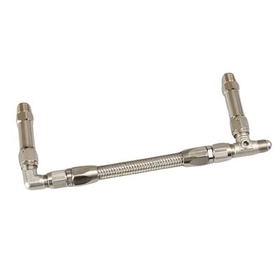

The hard line they included was ok but I’d need to change some things around. I ordered this other fuel line as I think it will fit even better.
I also ordered a jet kit in case I need to tweak it.
See less See more
Reactions: 2
Do NOT use teflon tape or sealer on the threads. For the AN fittings, torque them several times off the carburetor; don’t over-torque them, but put a little grunt on them. That seats them into one another without putting any load on the carburetor body itself. AN fittings don’t require much torque for service so don’t get carried away on final assembly.
If you want to keep from dinging up your shiny new fittings, line some crescent wrench jaws with electrical tape 😉
I think you can get fancy aluminum AN wrenches. For a part that will spend a majority of its life buried under the air cleaner I’m not overly worried.
Yeah, I’ve been meaning to buy some AN wrenches. For about 20 years now 🤣
Reactions: 1

New fuel line feed looks really nice. Of course it’s buried under the air cleaner.
