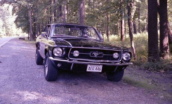

When I turned 16 I knew I wanted a muscle car. I wanted something small and light with a big block engine. At the time, muscle cars weren’t very popular as it was the start of the energy crisis of the 70’s and big block cars got poor gas mileage. I was searching for a big block Nova, Camaro, Dart, or Mustang. The only thing I could find in my price range was a big block Mustang. It wasn’t in very good shape, but I wasn’t very knowledgeable about cars and didn’t’ spot some telltale signs of real problems that would be obvious to me now.
This Mustang was my 1st car and I bought it while I was in high school. I purchased it in Landover MD in 08/1974 from the car’s 2nd owner. I drove it regularly (if and when it was running) through high school, college, and after. It was my daily driver from 1974 up until 1987. During that time it was not treated gently. It spent several winters in western Maryland, which sees plenty of snow and road salt. I drove it everywhere, regardless of the weather or road conditions, including some off road excursions. It was driven hard and put away wet, always being stored outside, which certainly took its’ toll on the car over the years.

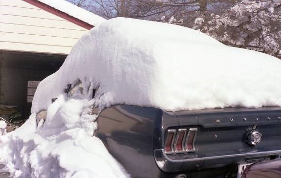

After Snow Around 1984

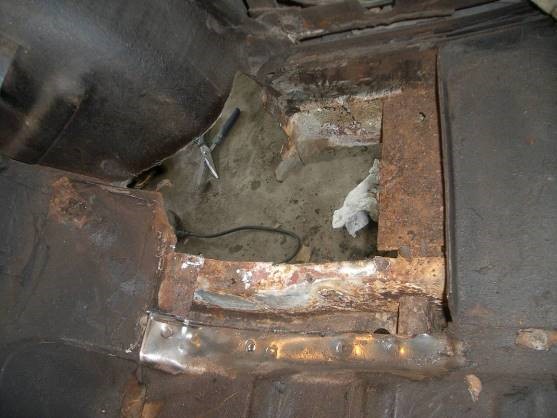

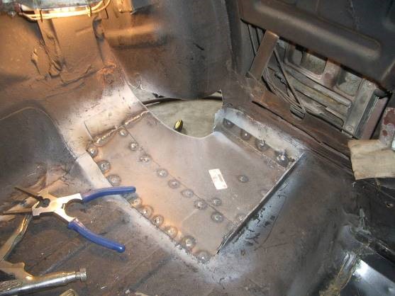

The car had its’ fair share of rust, so the body was the next larger project I chose to address. I discovered that the front fenders had rags stuffed into rust holes that were then covered up with body filler. One of the rear quarters was pretty much made of body filler and both of them were badly rusted. It’s hard to imagine a car could be that badly rusted after only 7 years. I replaced the fenders and then had a local “Mustang restoration shop” replace the rear quarters and patch the rusty floor pans. After their 3rd attempt at repairing the car I ended up with rear quarters that didn’t align with the trunk lid and that started popping back off after a few months. I wasn’t happy. The shop didn’t stay in business much longer after that.

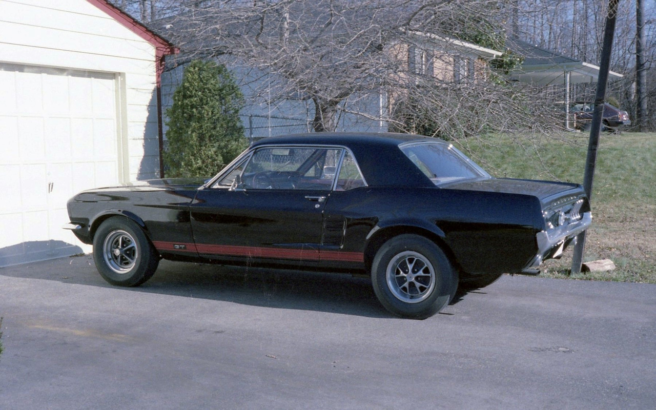

These pictures were taken in 1980. The car was painted in the late 1970’s.

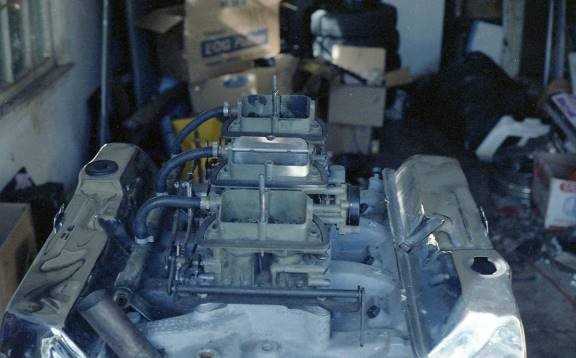

Eventually I got the high performance bug again. I pulled the original engine and stored it in my parent’s garage while I swapped in another 390 with a 428 crank, 428 CJ heads, and a factory triple two barrel intake and carbs. Unfortunately just after I installed the engine and before I could even start it somebody stole the intake, carbs, and valve covers right off of the car. Whoever stole it did it in broad daylight while I was at work and the car was parked in my driveway. I was able to purchase replacements and did eventually get the engine running.

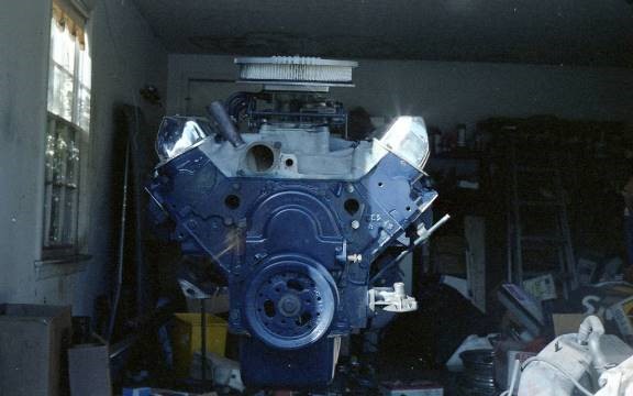

These pictures were taken just before I installed the engine and the parts were stolen off of the car.

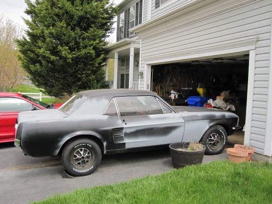

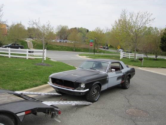

Here’s how the car looked when I backed it out of my garage after sitting for 15 years.

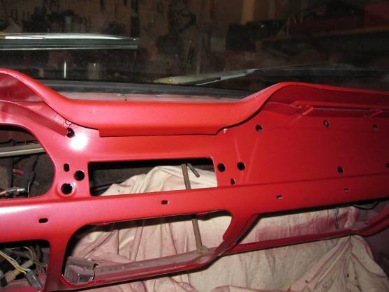

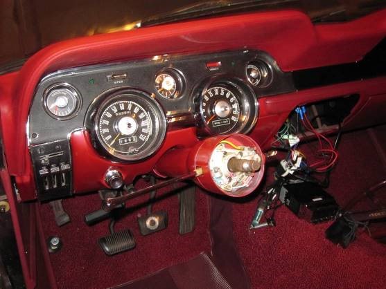

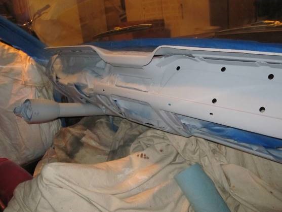

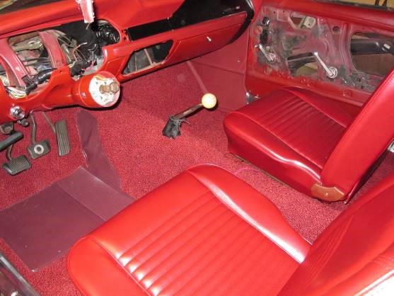

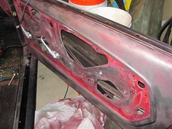

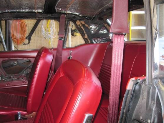

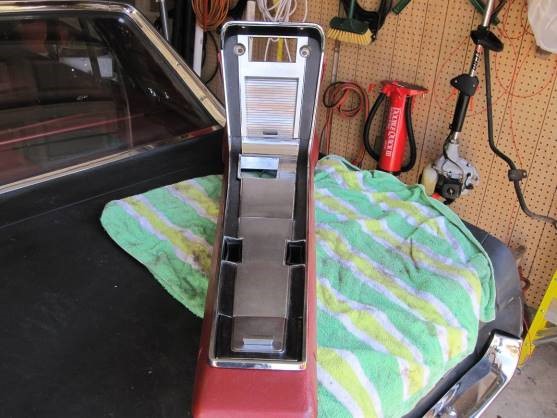

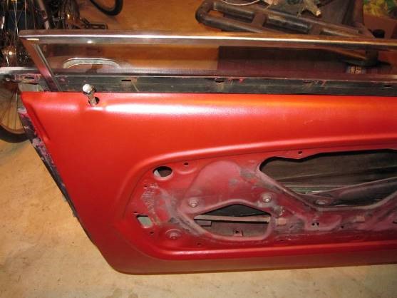

I completely gutted the interior of the car. I stripped, primed, and painted the dash, doors, and quarter trim panels. I installed sound deadener and insulation throughout the interior and trunk. I installed new seat foam and reupholstered the seats. Since my seat belts were in pretty bad shape, I replaced them and installed 3 point belts in the front. My console was pretty badly cracked, so I located a used base, refinished it in red, and transferred all of my old console parts to the replacement base. I replaced my instrument cluster bezel. Then I reassembled the interior with all new or reconditioned parts. I felt it came out pretty well and I have received compliments at the shows I’ve attended.
