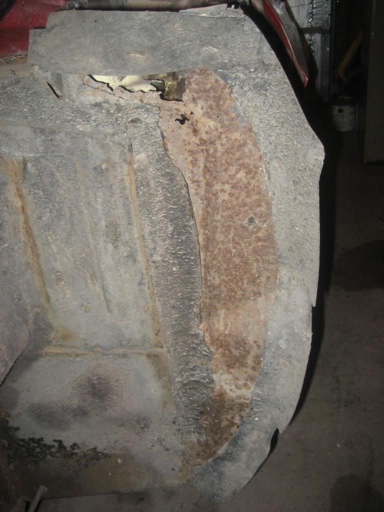

I started the disassembly of the front end today.. the intention of the restoration as far as body work and clean up of rust is going to be in 1/3's.. from the front end to the end of the fender (and everything inbetween). So i tore down as far as i could without getting down to the nitty gritty and i have a few questions:
1 I have found a part i need to replace due to rust, but i do not know what in the world this part is called. Easiest way to describe it is if you look into the cars wheel well with the fender still on, its the panel most twords the rear. If the fender is off, it almost follows the line from the front of the cowl down. It has some kind of rubber material wrapped around the edge of it where it comes into contact with the fender. I dont know how to post pics or i would, but thanks ahead of time for giving it a guess without visual help
2 Is there any way to clean out the inner cowl without drilling out the welds. Im pretty sure there isnt, but id sure like to know if there is some fancy trick out there..

5
Front side
Back side .. rust in the side cowl piece shows in the bottom
Top with obvious rust issue
This hole is about 1.5 "x 1"
both sections of rusting
The other side is in fine shape, although i need the two front splash guards. The kit sells for 60 or 80 bucks, so ill just replace the other side. Seems like its a simple bolt part, but im not so sure there is not some tack welds in the top.
Any suggestions on how the top section of the cowl should be removed? Im talking about the cowl that runs across the bottom of the windsheild. Word on the street is Ford never decided to do any rust prevention under there, and with the amount of work im doing, i think it may be silly just to ignore it.
As far as undercoating goes, if the old undercoating is sticking, i shouldnt have to worry about rust under it, correct? Also, should i worry about new undercoating not sticking to the old when its sprayed?
