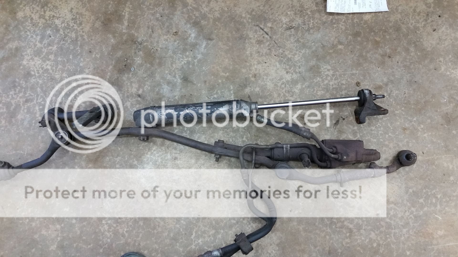

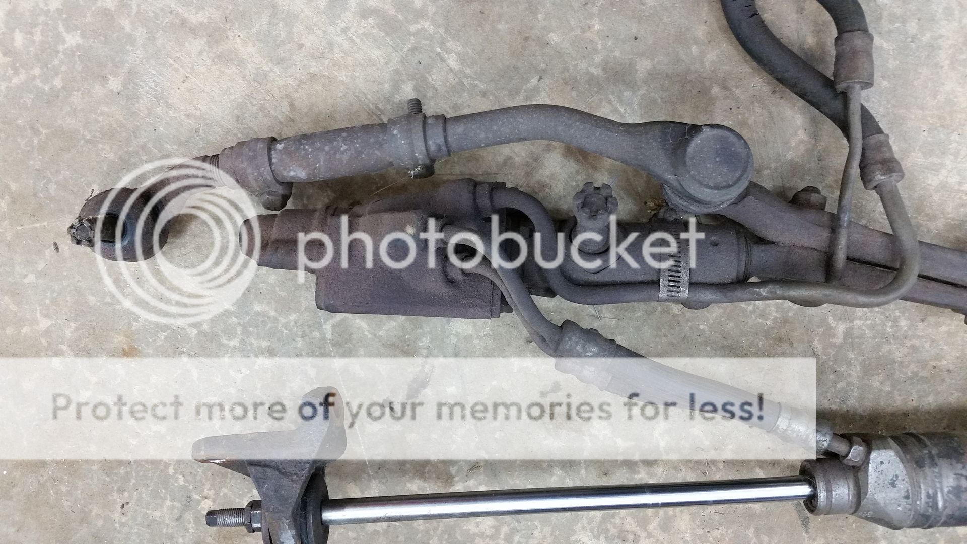

Can anyone tell me what power steering unit here is the 6 or 8 cylinder one? I think it's the darker unit, but not sure? I need to restore one of the units for the V8 car I have and both came with it. I want to say that the 5th pictures down tells me that is the 8 cylinder unit? The car was originally a 6 cylinder car, but is all changed over by PO. Thanks for any input.

It's a 6 cyl unit. The key is the control valve is mounted to a small shaft that is bolted to the center shaft. On the V8, the center shaft screws directly into the valve body. Talk to Chock, he is the expert here and can help you get set up with the proper parts.

So you think the one in the 5th picture down is the 6?
I don't know why the pictures came out in a different order, but there are two different units there. I was thinking the darker painted one was the 6, but this is why I'm asking.

This is 6 cylinder:
This is V8:
At least the I6 valve has the band clamp on the tubes. Make sure you have one when you are done, too.
5,121 Posts
The black one is the V8, the brown one is the 6 cyl. In the pic 22GT quoted you can see how the 6 cyl uses the 2 piece center shaft. The clamp he refers to is critical as well. If it isn't installed the hoses will flex and begin to leak.
