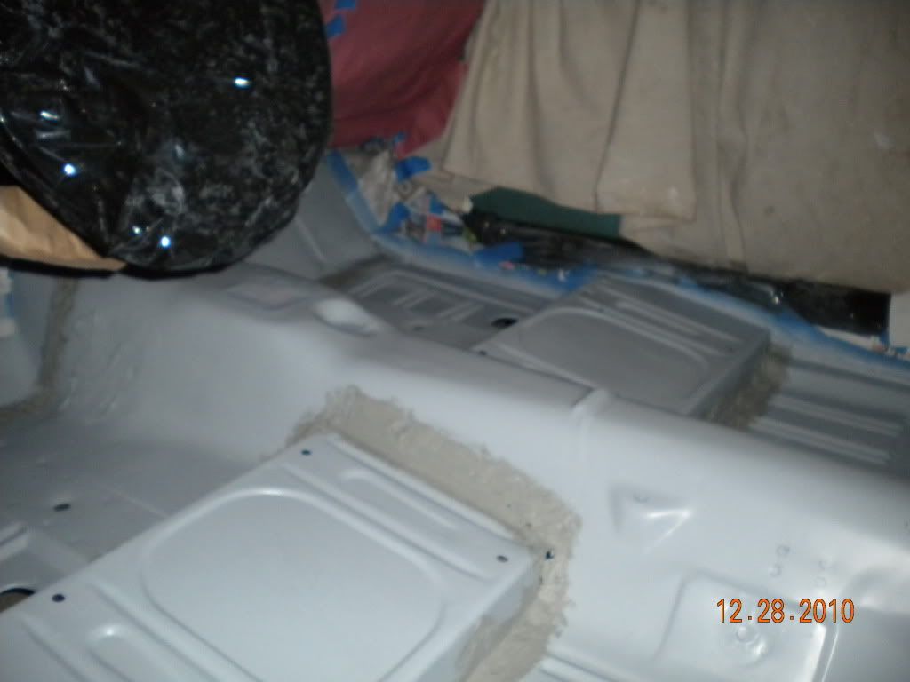

After I removed all that 45 year old carpet and insulation, which smelled terrible BTW, I discovered a nearly rust free floor board!
After countless hours of elbow grease, steel wool, laquer thinner, and rags it turned out looking very nice and ready for primer, paint, and seam sealer.

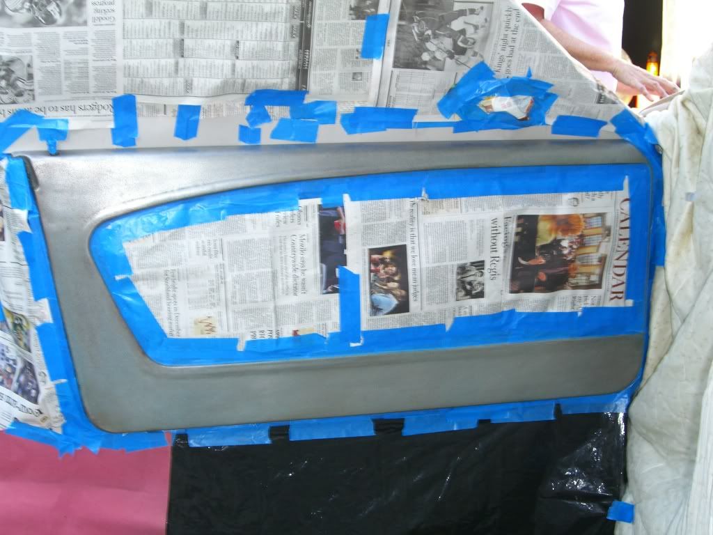

To remove all 4 layers of old paint on the rear quarter panels I used Easy-Off HD, which worked wonderfully! No easier way to remove paint than to spray a ton of Easy-Off on the panels, let them sit in a trash bag overnight, and get at them with some steel wool, lacquer thinner, and rags.
I primed them with SEMs self etching primer and painted with paint from NPD. (Don't have pics of them done at the moment, will post them later).
On to the doors, which were a PITA to prep but the came out really nicely. However, the 'Light Aqua' paint NPD supplied was way too blue, but its too late to redo it. Oh well.
Moving back to the floor pan, I installed some R-Blox sound deadening material, which is similar to Dynamat at only a fraction of the cost. It went on fairly smoothly with the help of a few friends and a heat gun. I also put in the carpet underlayment to help the ACC carpet have a more snug fit.

Here's what the kick panels and rear panels look like after being primed and painted. Notice the difference in color? The kick panels are much more 'blue' than the 'aqua' rear panels. VERY FRUSTRATING after doing all this work, but I'll have to live with it for now. Way too much work to prep the panels again! On a positive note, this blue works very well with the headliner...so its not that bad.
Yelostang - I think you're right. They must have mislabeled the rattle cans at the warehouse. I'm going to call them this week and see what they can do for me. NPD is great, but they sure screwed this one up!
