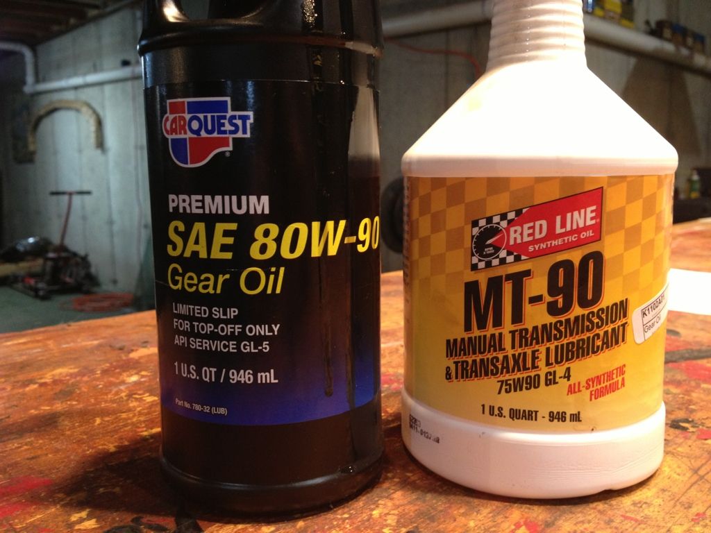

This is what I run, with no issues. GL-4 in the transmission, GL-5 in the rear axle.
