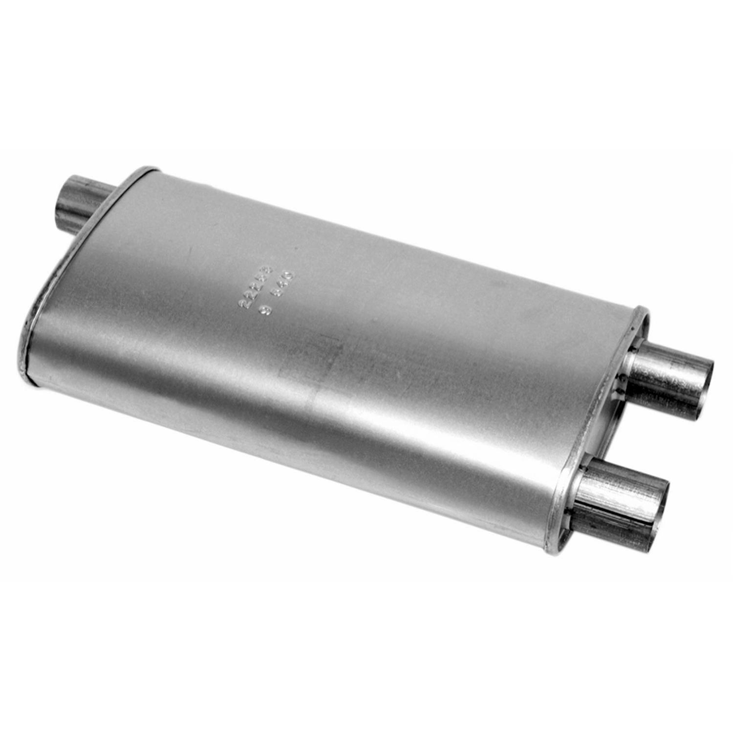

Im thinking about the exhaust system for my 67 with a 250.
The 85+ Camaro also used a transverse muffler, it has the same dimensions as the Mustang muffler give or take a 1/2 inch. The Camaro muffler has a single 2 1/4 or 2/12 inlet and dual outlets.
The 85+ V8 Camaro was rated at 145-245 hp. My 250 will be somewhere in the 125-145hp range....I hope.
Im thinking that I could run a single 2 1/4 or 2 1/2 pipe to the transverse muffler with dual outlets.
If thats more trouble than its worth, I will run duals with two 30in glass packs and see how those sound. I like more on the quiet side, I rode big marine diesels for 22+ years and Im not into a lot of sound.
Unlike a falling tree, when a big marine diesel engine lights off and there is no one to hear it, its still damn loud.
Walker makes the replacement muff:

Why not run something like this?
Mustang Dual transverse exhaust system - #5210-12B - National Parts Depot
You could run split dual headers, or y the exhaust manifold to tie into the dual exhaust. This would be simpler than trying to convert the Camero muffler as all the fittings would work. The dual exhaust would have plenty of breathing for your 250 and sound quiet.

What I like about the Camaro muff is that I can run a single pipe back to it and still have the appearance of factory duals. Less hardware, less weight, less complicated. Ive got a good muffle guy that likes working on classics so he can tuck it up just like the factory muff.

Its not Camaro stuff. Its a muffler made by Walker that has mulitiple applications.
Duels are really unnecessary on a six unless you have an Oz or Aluminum head.
My thinking is that it will not be loud, have the appearance of duels, and not hang under the car. If its to loud I will have room for a resonator.
Im going to buy the muffler and look at the feasibility. I can return it to Summit if I dont like it.
