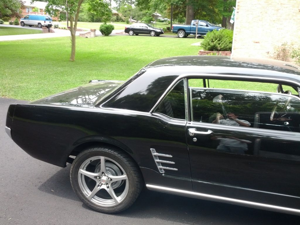

Got a few pics today real quick before the rain rolled in. Took her for a short spin today and replaced the filler tube gasket and gas cap gasket. Seems to have made her run better....am I just imagining this? Maybe lol.
Please..ignore the rims. I know they don't look great on the car but they're what I've got at the moment. I'd rather sink my cash into the engine and functioning portions first before buying correct rims. :)
Also...anyone have any idea what the deal is with the vinyl looking thing down at the base of the car on the side? Just above the rocker panel trim. Those aren't original are they?
Wow I actually like the looks of your car! I think those wheels look good on it. Rears need about 1/2" spacer to move them out a bit. I'd keep em! But I do like the more modern mods over the old school look. Still love the old school cars, but love the restomod look.
That vinyl looks like an attempt at some kind of rock protection for the paint. Not really necessary IMHO.
Are you gonna keep the bolt on scoop? Looks good on the car, but that gap at the rear of it kinda ruins it I think.
Actually there is no gap..it just looks like that in the picture bc of how the light was. If you like the wheels ill sell them to you ;) i get why people like them but i prefer the oldschool look
