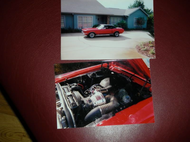

15 years ago when I had a Paxton put on the 289 in my convertible the speed shop told me it took 50hp to turn it. Maybe they were full of it the car was decidedly weaker on the low end after the install.

"....... 15 years ago when I had a Paxton put on the 289 in my convertible the speed shop told me it took 50hp to turn it. Maybe they were full of it the car was decidedly weaker on the low end after the install..........."
sounds like they were covering up for s lack of expertise with the installation. you should have had a power increase from 1,200 rpm and up. At full 6 lbs boost there is net HP gain of around 130 without any other modifications.

"......... 15 years ago when I had a Paxton put on the 289 in my convertible the speed shop told me it took 50 hp to turn it. Maybe they were full of it the car was decidedly weaker on the low end after the install........."
A pal over at one of the supercharger forums found this graph for me. It's a little like deciphering a weather map, but the gist of it is that at maximum flow the supercharger is requiring about 24 HP, but at that point it's making about 150+, for a net gain of 125+.
At low rpm it's using 4 HP to drive it. It takes under 1/2 lb. of boost to overcome the horsepower loss at the low end. Note this is a graph of the older VS-57 from the 1950's. The SN Paxton series (Shelby used the SN-60 in 1966) is more efficient.

Okay. I can't argue with numbers. This was bought at powered by ford in downtown Orlando probably 15 plus years ago. When it arrived I opened the box in the shop to inspect and thought it was damaged as I could not turn the pulled on the unit. The gypsy behind the desk told me it takes 50hp to turn it which surprised me as I thought it would easily turn by hand. Shows what I know. That being said I was never happy with the bottom end of the car after the install. Felt like it needed its nuts revved off to make the power. Cheers. Peter

"............. When it arrived I opened the box in the shop to inspect and thought it was damaged as I could not turn the pulled on the unit. The gypsy behind the desk told me it takes 50hp to turn it which surprised me as I thought it would easily turn by hand. .........."
there is normally some resistance to turning the supercharger pulley by hand. But they will turn. So there might have been some damage or improper assembly of the head unit.
at some point give vintage Paxtons another chance. Buy one from Craig of Paradise Wheels and you not only won't be sorry, but you'll have a lot of fun to boot. His contact info can be found here:
