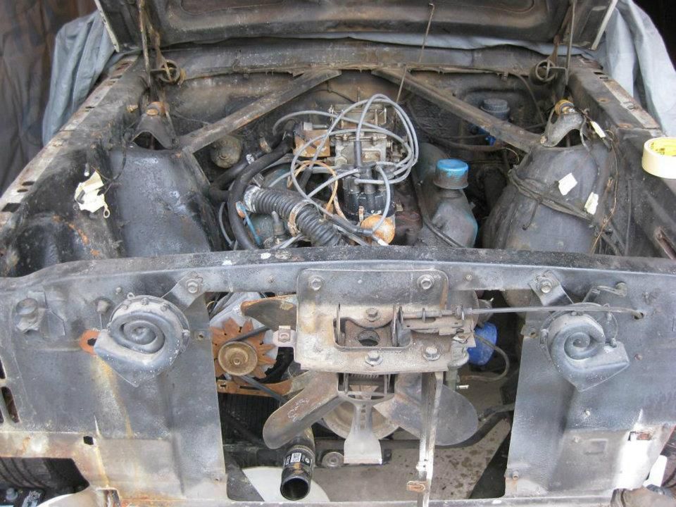

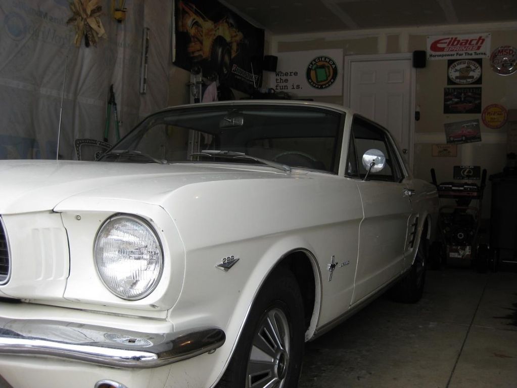

After selling the Charger my late father and I built together I was looking for another car. Found this one online fairly local and had what I wanted, V8, stick, no power anything and was complete. Upon disassembly she had lots of rust issues and I thought about tanking the entire thing. Instead, maybe foolishly or not, I went back to my roots and dug into it. Sold some other stuff to buy the welder and tools needed and started disassembly in my garage. Here's her journey.
Car looked really great... they hid a lot of the wrong really well.

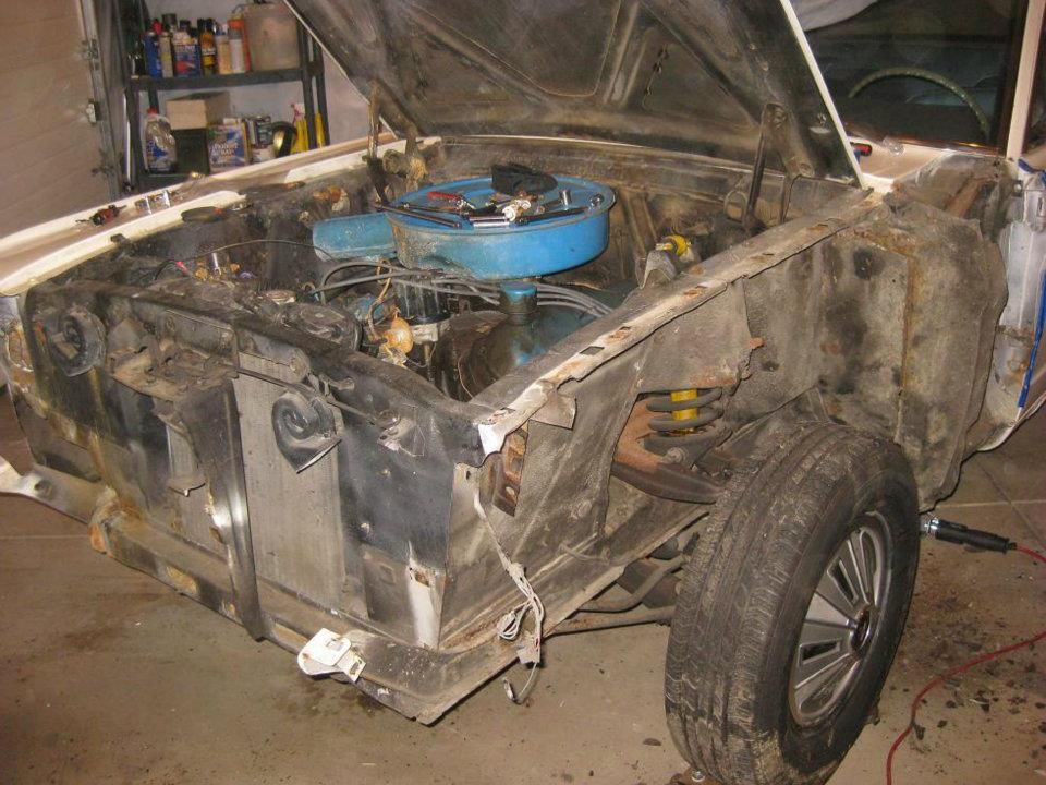

Started tearing her down.

Once the front end was on a jig and damage assessed, I started on the drivers side.
