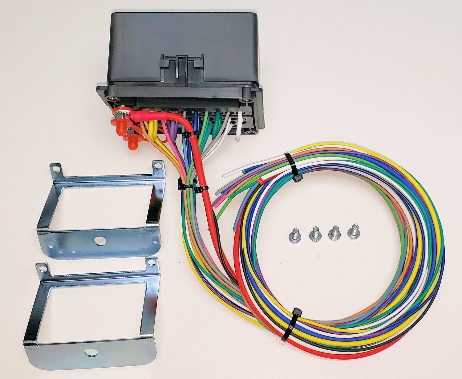

There are plenty of cheapo brands available online. But I'd rather have dependable than cheap.
Is there a preferred brand for relays?
Is there a preferred style?
I'm just doing headlights for now. But will probably do horns and DRL later.
So I'm considering this nice prewired box, but I'm not sure I want to shell out the mulah. I could move my electric fan relay to the box as well.
It looks like a nice quality piece.
33 Posts
I stick to Bosch relays which you can get cheap. Buy some relay harnesses as well and forget that $150 relay pack.

Use Bosch relays, they are all wired the same so there is no real reason to get the prewired relay block, especially for the money they want for them. You should move the horn relay on your list to the ones you are doing first.

I did similar to that box, but did not buy the pre-built. I went with 14 ga output wires and 6 ga input. 8 ga would have been too small for a 5' run to the battery.
