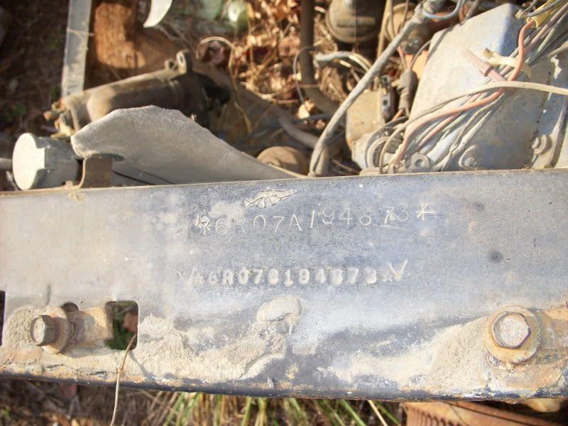

WE've all heard the term "Rebody" before but how about this one..... ReVingining. Basically this term applies to someone who changes an engine from a C-code to an A-code or K-code or R-code and changes the engine letter in their VIN to match the new engine code they installed. This car was originally a C-code 66 coupe (that I was told was a K-code GT) When I checled out the VIN on this car it had four of them stamped on it. All four were on the driver's side. Two were stamped in the front driver's side apron and two were stamped into the top of the REAR driver's side apron. Two of them were the original VIN stamped by Ford (the C-code) and then there were two more VIN's stamped right next to the original that were identicle to the original VIN with the exception of the "A" in the engine code spot. Obviously the "A" code VIN was not original. Funny thing was the title matched the "A" code vin! LOL They even tried to duplicate the little star. Not being real familiar with the 65/66 models.... were both factory vin's stamped on the driver's side??

My 65 from San Jose (schedule build April 1965) had three VIN stampings in the engine compartment. One in the "cut out" area, and one on each side between the shock towers and the fire wall, on the top of the fender aprons, just under the edge of the fenders.

Yes, this one did too. I was not familiar enough with the 65/66 models to know where their VIN stamps were but I assumed it was the same as a 67/68. I was surprised to see VINS stamped on the REAR aprons on both sides. The RF apron was MIA so I do not know if it had one there too.
As far as buying the car.... I was told it was a "K" code GT coupe with its original hipo engine. If it was I was going to try and lock it in. As so often is the case it was not a hipo engine, it was a late model roller 302 but it did still have its original 4spd, shifter, T-10 and bellhousing as well as the pedals. The front fenders had the GT emblems on them but they are off of the car. The door tag had a "K" in the color code, NOT the engine code on the replacement door. It did not have disc brakes so I assume it was not even a GT. The Rear is supposed to be a 8" traction loc but one side would turn independent of the other. The guy was wanting $600 for two cars, this one and a fairly solid and complete 66 cylinder 3spd coupe (missing its drivetrain) with a nice console in it. All of the parts for the yellow 66 are in both cars. But his price was based on the fact that he thought the trans in the one car was a toploader, which it is not. So the two cars could probably be picked up for $450. Here is a pic of the two cars.

That is how all 65/66's are suppose to be from
the factory. I have a 65 built Oct 64 that way
and I have seen many others the same way.

For $450, seems like a decent deal whether the VIN is right or not.
Dusty, was the second VIN clearly a fabrication? I have heard of Ford restamping the correct VIN right beside the wrong one. But then you get into which one was the correct one...

Yes, the "A" code vin is a "customer" add on. It is croooked and of the wrong font. Yeah, they are probably a good deal since the 66 body is actually very solid and would need no panel replacement. The console, 4spd stuff, two sets of clutch pedals alone is worth the asking price. I've just got no place to keep them right now if I were to get them. If it was a K-code, I would have made room.
