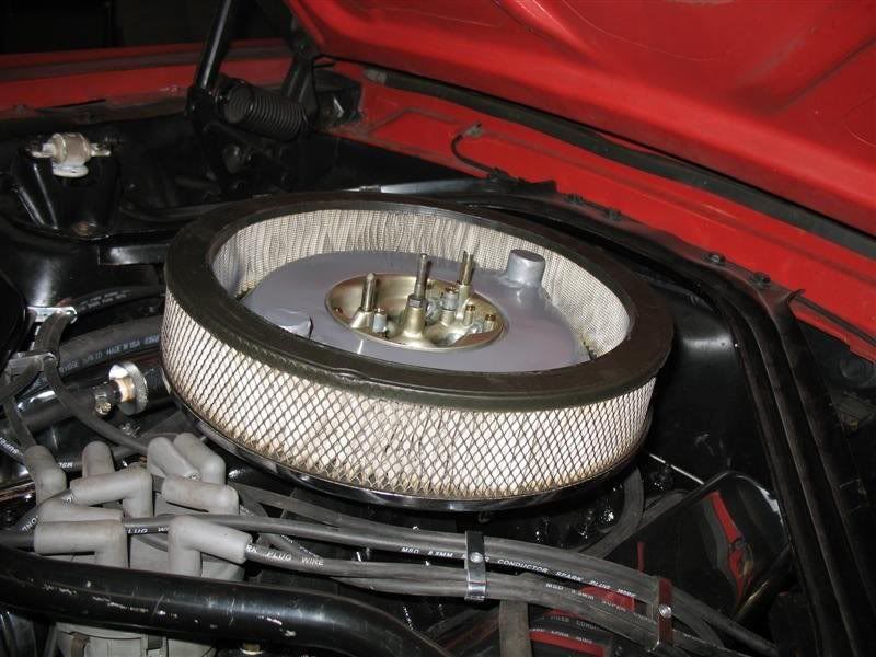

There is a way to put a Vic Jr under a STOCK Mustang hood. Had one under my street/strip 65' with a 393w that ran 11 flat several years ago. Here is how I did it:
A Vic Jr's carb flange can be angle milled. I removed .300 from the front of the carb pad and tapered it to near zero removal at the rear. That substantially drop the front of the modified 14" air cleaner I used.
Used dropped motor mounts. At the time mine where stock 65' Mustang 3 pc units but they really aren't strong enough for long term performance use (even with a through bolt.) I now use Ron Morris drop mounts similar to what Juiced Coupe mentioned. With either mount the Canton oil pan I used just touched the tubular cross member so that should give you an idea of how low the motor is in the engine compartment.
Carb selection. Use a "chokeless" carb such as the original Holley HP series (not one that has the choke removed.) The chokeless carb's air cleaner mounting location if somewhat lower than the choked type. I had used both a Holley 750HP and later a 950HP.
Modify a drop base air cleaner. I've modified 14" "Holley" brand drop air cleaners. Basically cut the carb flange ring area off of them which drops them substantially. If this is done the float adjusters of the Holley will be the next interference. I drillled 3/4" holes to allow the adjusters to pass into the air cleaner and then cover them with 3/4" EMT electrical conduit extensions, capped with knock out plugs from an electrical 4x4 box.
There is always a chance that your 67' hood has more of a crown than the 65' hood since it could also house an FE motor.
Although the milling of the intake and the severely dropped air cleaner base were not an ideal situation, the 393w had no problems screaming to 6600+ rpm's at the track and I did get it down to 11.0x (full weight car and driver) before I started using other combinations that needed a hood scoop.
Photos of said 393w:
The fancy 3 bar air cleaner hold down nut would not work under the stock hood. There are shorter hold down's available.
