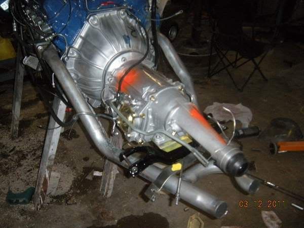

2,965 Posts
I just painted my crossmember yesterday and bolted it onto my transmission today. There is at least 1" of difference in height.
