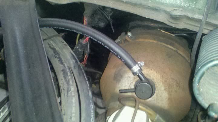

I'm only pulling between 15-16". While searching around for possible problems, I noticed something interesting with my brake booster:
Is that second tube supposed to be connected to something? Plugged? With the vacuum gauge attached I covered the hole with my finger and vacuum jumped to around 17" (although the engine bogged a little so I'd imagine retuning the carb, checking the timing it might pull a little more).
Thoughts?

I have never seen a brake booster like that, but then again I've never owned a '68. Any unused vacuum fittings should always be plugged, though. An open fitting in a vacuum system is like a short to ground in an electrical system. You will probably be able to lean your mixture a bit afterwards.

Thanks for the quick feedback! I figured it shouldn't just be open, but I wanted to make sure it doesn't have some special purpose that I'm neglecting. I bought the car about 6 months ago, replaced the intake manifold and carb about a month ago, and have actually been driving it. I just noticed the low vacuum when I was tuning the carb and finally got around to asking :)

On some cars the auto trans modulator was connected there. Cap it.

if its sucking air plug it

Plug all the vacuum ports and see if your vacuum improves. And dial in more than 6 degrees initial timing. That will raise your vacuum.
