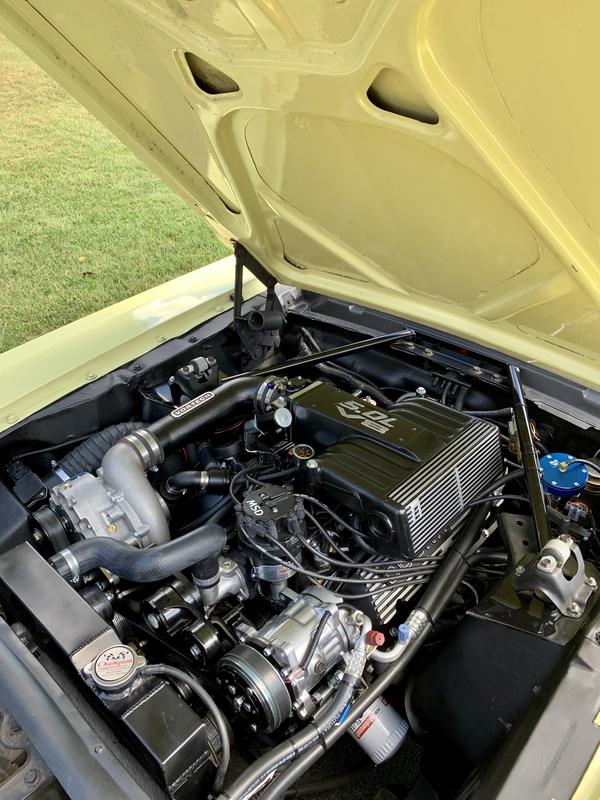

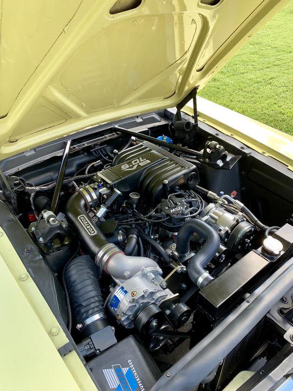

I finished my Vortech install over a year ago and never shared. I wanted to share a few pics of how it turned out. I went with a V3 SCi running with the 3.125 pulley making 9-11psi depending on the temperature outside. It was a kit designed for 86-93 Foxbody cars and it bolted on pretty uneventfully. I was going to write a how-to because there is not much info online but the install really just didn't require one. If you can follow Vortech's directions, you are set. The only modifications required were a little trimming to the charge pipe and a little trimming to the alternator mounting tab. Everything else bolts right on if you are running Foxbody serpentine front accessories. I am using their FMU with 24lb injectors. I Plan to ditch the FMU and switch to Pro-M's Engine management computer/harness system with much larger injectors this year to make the most of this cars potential. If anyone has any questions before they attempt this, I am happy to share my experiences. Oh, and with the 306, TFS 170's, Explorer intake, 4r70w, 3.25:1 trackloc, the car is a blast to drive! 1st and 2nd gear go up in smoke!

Nice car, very clean 5.0 EFI install, I'm curious...didn't see a TFI module on the distributor and the supply and return fuel lines seem to exit at the rear of the engine, are the fuel rails and distributor from another Ford other than a Foxbody?

Man, that looks like fun. I really dig the paint treatment on the Exploder intake. Fits in nicely with the valve covers.
edit: which export brace is that?
