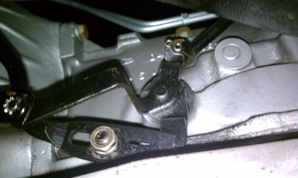

70-73 Mustang FMXs had the dual arm on the selector, one for the lock out rod on the column and the other for the transmission. 69 and earlier only had one. I recently sold one for a 70.
70-73 mustang fmxs had the dual arm on the selector, one for the lock out rod on the column and the other for the transmission. 69 and earlier only had one. I recently sold one for a 70.
then i likely don't have what he needs as this came out of a 59,000 mile car. But i'll double check as there is no telling what has been swapped in and out in 40 years.

Thanks guys. I actually had to break down and purchase a whole transmission becasuei found out that my tailshaft housing is also incorrect. It is very long as if it was fora galaxie. I rebuilt the wrong trans!!!
