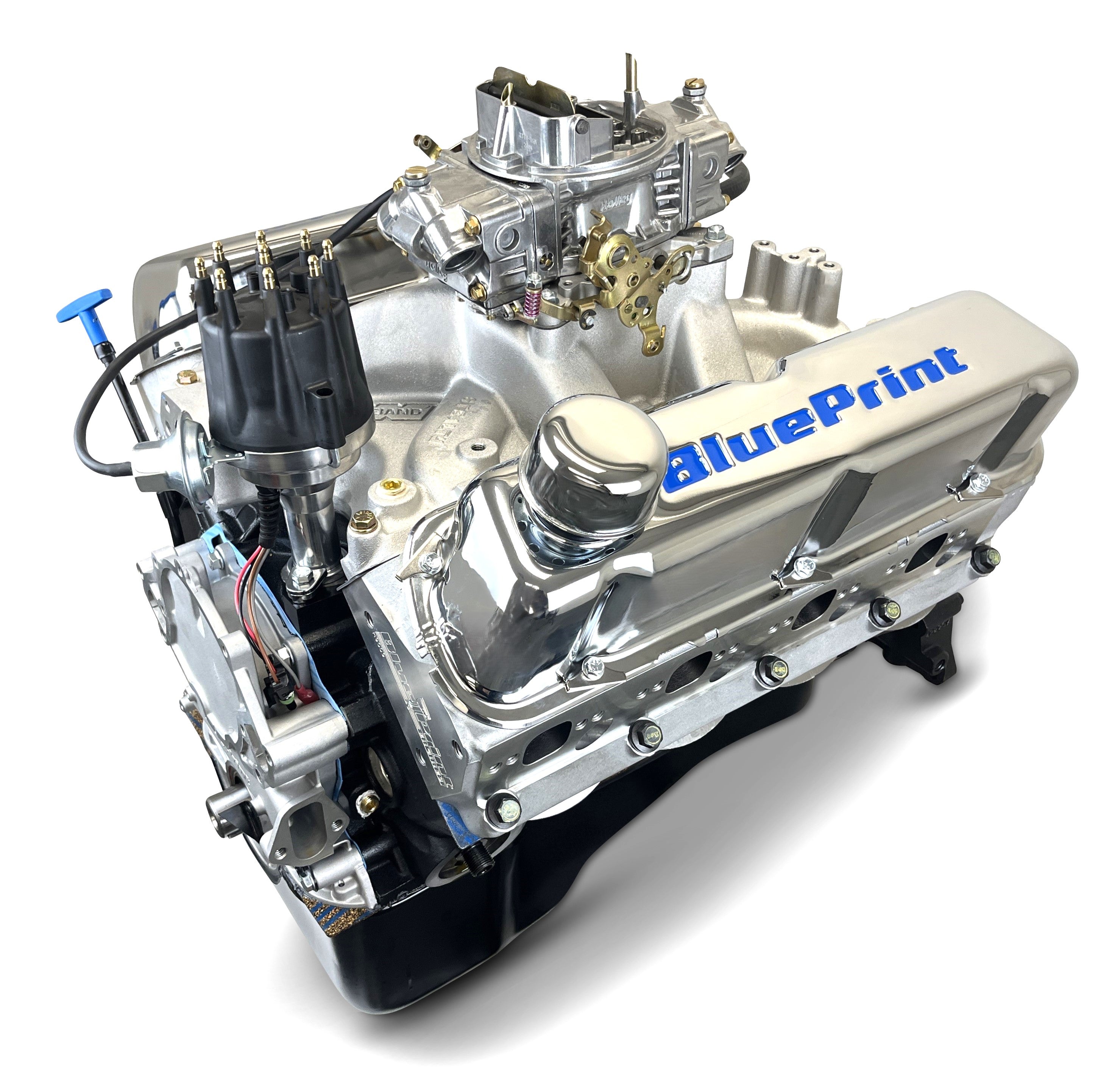

Blueprint 450HP 408W with intake, carb, distributor @ $7,399.00
Tremec TKX @ $2,795.00
Add headers/exhaust, fuel & plumbing, clutch, flywheel, water pump, clutch linkage parts, driveshaft, shipping and the small stuff and you're probably just slightly past your $12,000 budget.

I linked the engine in my first reply to you. An old 5.0L has like 225hp, it's not going to be easy to make 450hp with it. More cubes = the easier it gets to make the power, and the easier the engine has to work to move the car along. A 450hp 302 isn't going to make a lot of power at low RPM, but the 408 stroker will do it quite effortlessly.
You right, I checked they are very low on hp.

To get a 289/302 to the 450hp range is going to take a lot more money than your budget allows. As I think you know already, a 351W stroker is the best way for the money to get to that power level in a vintage Mustang. I run a 393W that runs somehwere in the 550hp-600hp range. It was built around 2008 and cost approximately $12k back then. The only Ford parts in my engine are the block and timing chain cover. I seriously doubt you can make 450hp out of a 289/302 for the money you want to spend. Power cost money.
For the transmission, I'm a big fan of a modern 5 speed overdrive if you're wanting to run a manual transmission. A modern overdrive transmission allows you to run an aggressive rear end ratio gear (I have 4.11 gears in my car) while being able to cruise at highway speeds with low engine rpm's. I have a TKX 5 speed in my car. It cost me $2,800 to my door earlier this year. I already had a hydraulic throwout bearing, scattershield, flywheel and clutch for my car from the TKO I had been running previously. So that saved me a couple of grand in ancillary items for the transmission. The TKX is a smaller case than its predecessor the TKO and doesn't require any modifications to fit in a 67-73 Mustang. A TKX would not need any modifications out of the box to work and last behind a 450hp engine. A TKX is rated for 600 ft-lbs of torque and 8,000 rpm. I would not use a T5 as they're not rated or designed for the power level you want.
That's just my opinion and experience. It's your money and your car. You build it the way you want. Unfortunately I don't think you can get a 450hp engine and a 5 speed transmission with a $12K budget.

Thank you for a detailed reply. I'm trying to budget it but if I will need to ramp it up, well, I will.
So far, with @1stLove help we found BluePrint Engines 408CI Stroker (450hp) which is $7400.
TKX 5 speed as you mentioned $2800
subtotal $10200
I think I can't put anything from 289 to this one so, there will be need

Yes, but count on at least another $2000 for additional parts for the engine (intake, carb, filter, fuel lines, headers, engine mounts, water pump, ignition) and also $2000 for the transmission (clutch, clutch pedal and linkage of some kind, bell housing, drive shaft, shifter, transmission mount).
Edit, my answer was to your post #35.
Great. Will add to the list and look for compatible items.
