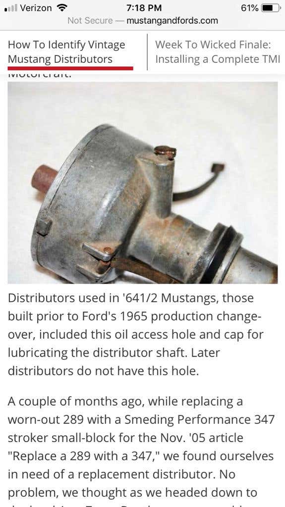

So it seems I don’t have the proper match. From what I could see on the distributor, it’s a FoMoCo stamp with number 12127 on it. Upon researching that, I found out that distributors used in 64.5 mustangs (prior to the changeover in 1965) had a little hole with a cover for lubrication access.
Sure enough, my distributor matches that and has the hole and cover. I’ll attach a couple pics from the research and of mine.
Can someone explain this to me? Did the previous owner possibly replace the distributor with an early 64.5 later on? Could the 64.5 distributor have found its way onto a 66 mustang on the assembly line?

From all I’ve read though, I believe my distributor is pre ‘65 as it’s the only time they used this type with the hole and cover below for easier lubrication (which I have). Sounds like they used those in the 64.5 and then made a factory change in 65 and older.

Thank you. But not all have the oil hole and cover. Sounds like that was only in the 64.5 mustang prior to a factory change in 65. So I’m trying to figure out how a 64.5 distributor landed on my 66. Maybe previous owner made that swap. Wouldn’t think it came off assembly line that way but this car is extremely stock so I’m not positive.

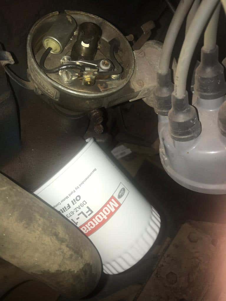

#24 ·
I hate to hijack, but am I in a similar boat here with my '66 6-cylinder? Both carb and distributor are original to my understanding and the repair records I have ('85-present & a few notes from 70s) do not indicate replacement, just maintenance. Also yes, the distributor is dirty, but pic was pre-removal as I'm cleaning and refurbishing all the things.
