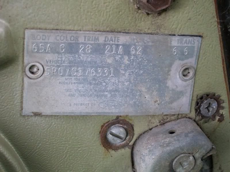

Here is a photo of my old data plate.
Was it originally a black background or a grey background? It kinda look grey, but is fairly well weathered.
The original color was Med Metallic Ivy Gold. Could that be found in both versions of paint, or only one? I am not sure what the difference is between the grey and black tags. Something to do with the type of paint. Would other Mustangs of similar consecutive number/build date be painted with the same type/color of paint, and therefore have the same type of data plate?
How rare is one color tag versus the other? Are they both fairly common?

The Door Data Plate in 64-65 could be Black or Grey depending on the Type of Paint that the Car was originally finished in. A Black Plate indicates M30J Non-Acrylic Enamel and a Grey Plate indicates M32J Acrylic Enamel. From 66-69 a Black Plate indicated M32J Acrylic and a Grey Plate indicated M30J Non-Acrylic.

"The Door Data Plate in 64-65 could be Black or Grey depending on the Type of Paint that the Car was originally finished in. A Black Plate indicates M30J Non-Acrylic Enamel and a Grey Plate indicates M32J Acrylic Enamel. From 66-69 a Black Plate indicated M32J Acrylic and a Grey Plate indicated M30J Non-Acrylic."
Yep, True dat True!
That's correct!
PS: That dataplate was definately Gray.
I had a Honey Gold coupe with black interior built in July of '65 at Dearborn that also had a gray tag.
