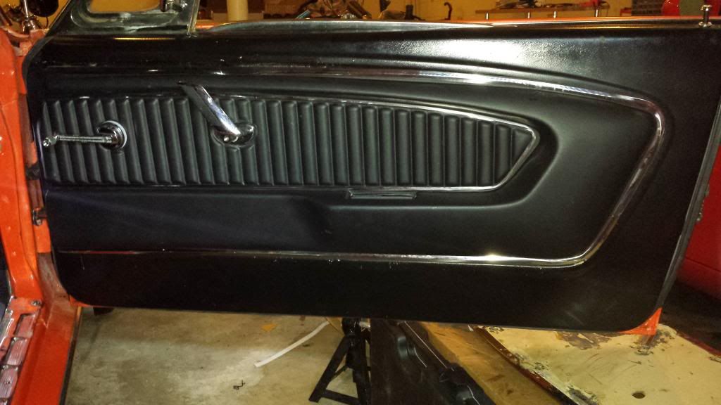

I have original 66 pony door panels that are in pretty good shape except the clip holes are torn up. Any suggestions how to hold the clips in short of recarding the panels.

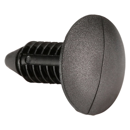

...why wouldn’t the later style plastic clips work instead of the metal clips?
I assume you are asking about this style of panel retainer.
You would need to cut a round hole in the cardboard panel for the head/upper flange of this retainer to fit through and then slide into place. And then the lower flange would hold the panel away from the door.
