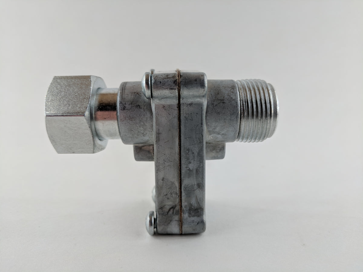

There are places that build custom adapters to change your speedometer gear ratio
On my street rod I ran into the same thing with my T5 needing a speedo gear they don't make. I used a 10% adapter that slowed my speedo down enough I could get a gear that would work.
I believe you're not supposed to use grease on the speedometer cable, only graphite.

this society speedo ratio adapter photos
has no email ...
only person to person :)
i think the cable at the bottom of the page is what i need.
