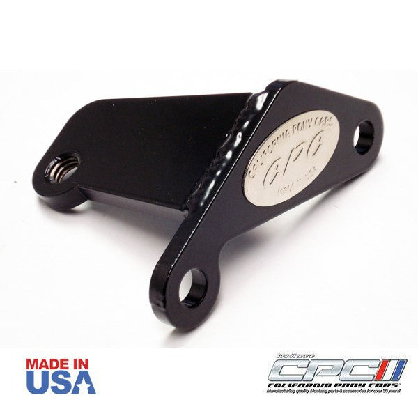

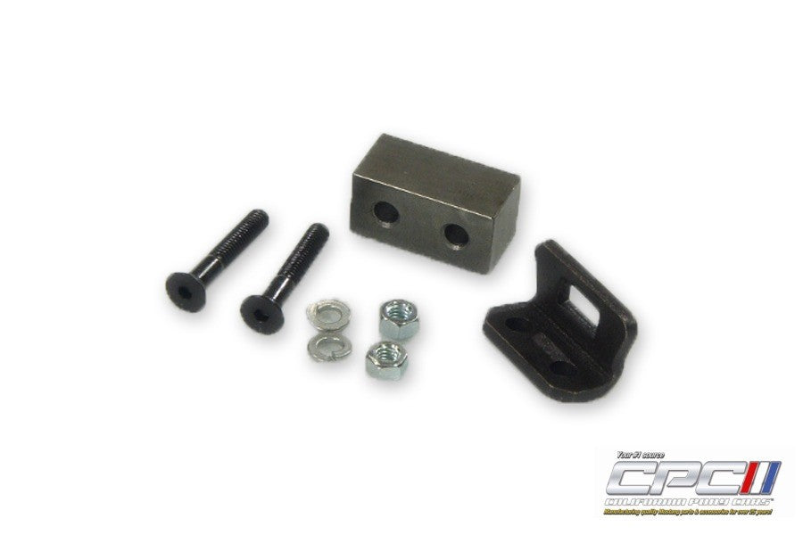

When you say "fulcrum adapter" which are you talking about, A or B?
A) the adapter bracket used on 5.0 engine blocks that are not drilled and tapped for the z-bar pivot stud.
B) the spacer that moves the clutch release lever fulcrum towards the engine.
Do your clutch release lever and the fulcrum match each other? The early release lever was held to the fulcrum with a wire clip. The later release lever had a sheet metal clip riveted to the backside and the sheet metal clip passed through a hole in the fulcrum. The CPC Fulcrum and Spacer kit includes the late fulcrum with the hole in it. If you are trying to use that fulcrum with an early wire clip release lever it may not work and is the cause of your "creaky" problem. I don't know what will happen because I never tried that combination.

They both have advantages. With the vintage bellhousing just bolt on the adapter and go. With the T5 bellhousing without the adapter, it's one less thing to go wrong. You have less stacking of tolerances. The down side to the T5 with the fulcrum, I don't think you'll find a boot to cover the fork opening. There was one off something like a F500 that fit but no longer available.
