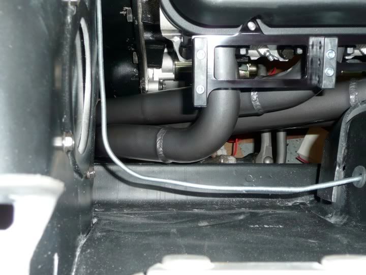

pics of my FPA headers install on my 408
13K views 36 replies 16 participants last post by  rc4mike
This is my current project....1969 mach 1. The theme is black and silver. A couple of people asked for photos. I am happy with the fit of my FPA headers and cable clutch clearance.
Looks great, gonna be a sweet ride. Seems to clear the cable at the bellhousing by quite a bit, plenty of ground clearance too?
I wasn't aware FPA made a 1 7/8" header for a 351W. Are you using a cable clutch? Got any pics?

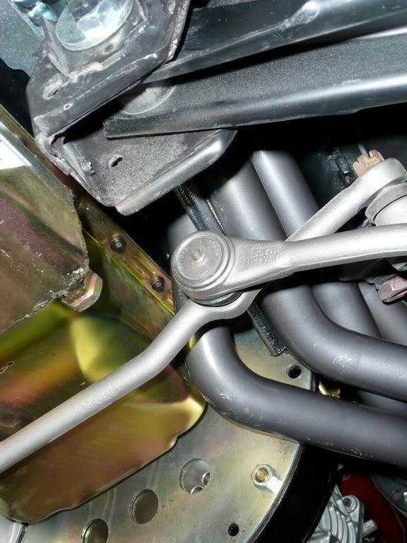

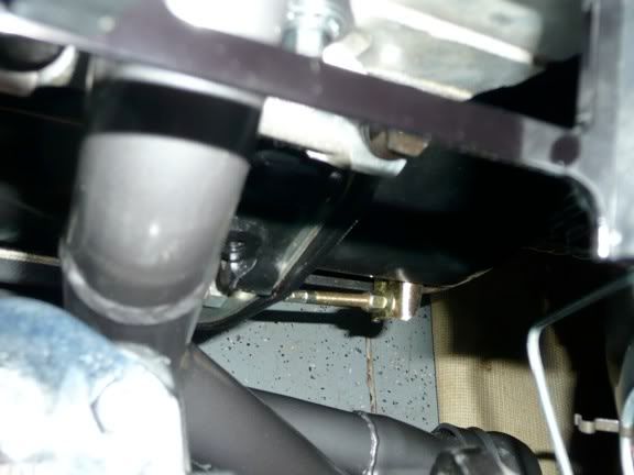

Yes, good ground clearance. It is just below the frame rail maybe about an 1". For the cable clearance, the no. 3 tube tucks close to the block while the other tubes (1.2.4) push out toward the shock tower and steering box. The cable sneaks between. My cable came with a 4" stripe of "header wrap" that protects the cable from the header (by tube 3 and 4). There is decent clearance. There is a lot of clearance by the bell housing where the cable connects to the clutch fork. On the passenger side it is tight by the scattershield (by the starter).
