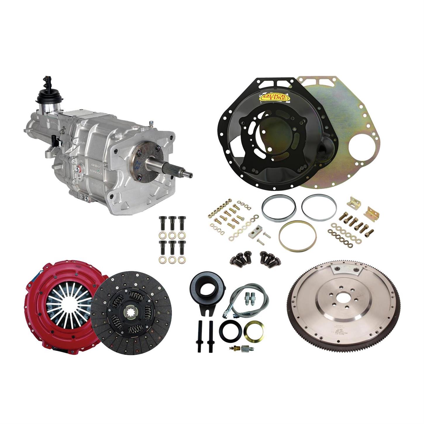

From my knowledge, I think you could. My 2002 has a TKO500 in it which is what the TKX is based off (3650 platform) and as far as I’m concerned the main issues would be bellhousing mating, input shaft, and clutch. I’m sure you would need a custom driveshaft or a T5 length one, but I’m not positive.
After looking online, I found this:
Should answer most questions.
