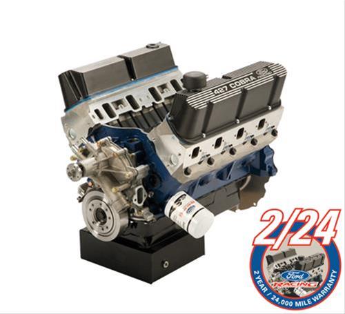

This is how I broke it down for my project. So, the engine and components were e hardest decisions I had to make. I saw that I had 4 choices.
Budget goal was $5k. My options were:
1) Crate motor (eBay, tuff dawg, jasper, Ford Racing, etc)
2) Premium engine builders, i.e.: Fordstrokers.com
3) reputable, local machine shop
4) Build it myself
Option 1: Crate Motor (Ford, Blueprint, etc.)
Pros: convenient, average price, warranty
Cons: average performance, logistics make warranty issues difficult, mediocre parts or just rebuilt stock parts
