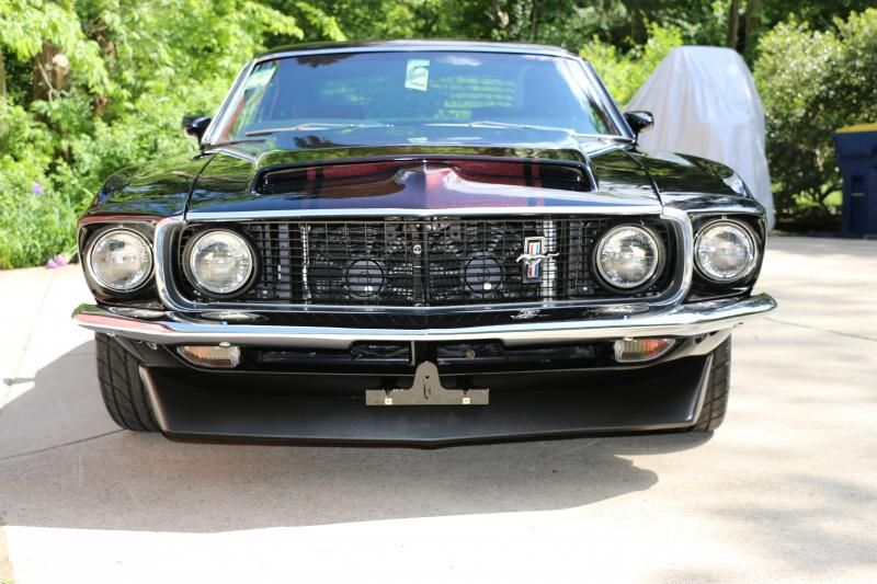

High hp motor and I use a pusher! Has worked great for 600 miles so far. See below
<a href="http://s9.photobucket.com/user/pvirg/media/IMG_3987.jpg.html" target="_blank"><img src="http://i9.photobucket.com/albums/a100/pvirg/IMG_3987.jpg" border="0" alt=" photo IMG_3987.jpg"/></a>
Well, you got two! My 68 doesn't seem to have that much room up front. What do you have going on there? Do you have A/C? It takes up some room I guess.
