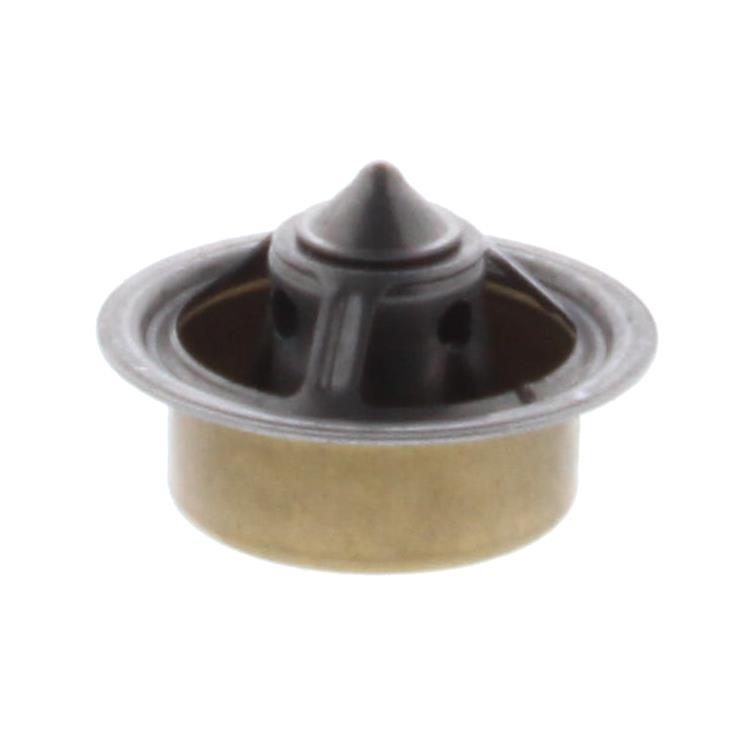

66 mustang with a 71’ 302 engine. Installed a new I think 190 / 200 deg (can’t remember) thermostat and refilled radiator. Fired up the engine and got it up to temp and was able to burp the cooling system with one of those spill free large mouth funnels, so I was able to have the cap off the radiator, but now for some reason when the engine is up to temp the upper radiator hose is super hot and feels rock solid like the thermostat isn’t open and my temp gauge reads 210 degrees? Am I missing something?

I appreciate all the feedback. It’s a mr gasket high performance thermostat. Just not sure it’s properly opening. All other radiator hoses when the thermostat opens you can squeeze them and they have some give to them because of the open flow of fluid, with it being so stiff it makes me wonder 1. I still have a few air bubbles in the system or 2. The new thermostat is trash and not opening regardless of temp and that is why the upper hose is rock solid with pressure.

Be sure to keep a rag around the water neck when you check flow. I had issues with the Mr. Gasket Performance thermostat. The rubber seal expands and it can't regulate the temperature. It stays partially open.
They are a cheap Chinese copy of the Stewart EMP high flow thermostat. I also run a 180 degree thermostat.
There are no issues with heat in the car. However, if you're in extremely cold climate it may.
They are both copies of the Robertshaw thermostat. You wouldn't want the thermostat from Stewart with the holes drilled in it. Thats defeating the purpose of the thermostat. A Robertshaw thermostat flows vastly more than a standard one. Holes increase the amount of time an engine takes to warm up and may actually impede it from actually reach the correct operating temperature.
I too had issues with the Mr Gasket version. I had two different ones (180 degree) open way early my car couldn't stay above 160 while driving.
@66fasty if you have issues with it down the road. Buy a quality version of the Robertshaw. I have one from flowkooler that works great. If you bought yours from the parts store its most likely a 180 degree. They rarely have 195 on the shelf.

Here is what I do. I check all thermostats by heating them up in a pot on the stove and watch the thermostat open and later close. To avoid trapped air I drill a small hole at the 12 o’clock position. During installation I hold it in place using a rubber band.
A 180 thermostat might lead to the case your engine running to cool.

I agree with Mustang4SF. Some thermostats come with the air bleed hole. If not I drill one in, place at 12'oclock position. With radiator cap off and no catch tank, level should be about an inch over tubes or inch from the top. When thermostat opens you should see flow in the radiator and you should be able to squeeze the top hose and see the flow change with your squeeze. Woodchuck was saying that the hose would be hard with the cap ON and the system under the 13-14 psi system pressure. If you have an overflow catch tank, with the engine cold, when you open the radiator cap the level should be all the way to the top. Many say 210 is not to hot. Whatever temperature thermostat you have installed, when you turn the engine off, does your car spit antifreeze out. If so, it's running to hot.
I've never had to put an extra hole in a SBF thermostat. The little bypass hose in the thermostat housing is more than adequate to pass coolant (and air bubbles) through...there's more than enough turbulence ahead of the thermostat to prevent a bubble from forming.... I've always had success with pointing the nose up hill and running with the radiator cap off through a couple cycles of thermostat "modulation" and topping off the rad.

I know you remember when many T-stats lacked any type of venting. The Robert Shaw/ Stewart EMP works great with the hot FE engine and the High flow Edelbrock water pump.
The Mr Gasket copy of the Robert Shaw unit rubber seal expanded and kept the unit open all the time so as you stated: Less than 50 degrees out the engine stayed cold while at constant cruise. It was open about 1/4".
