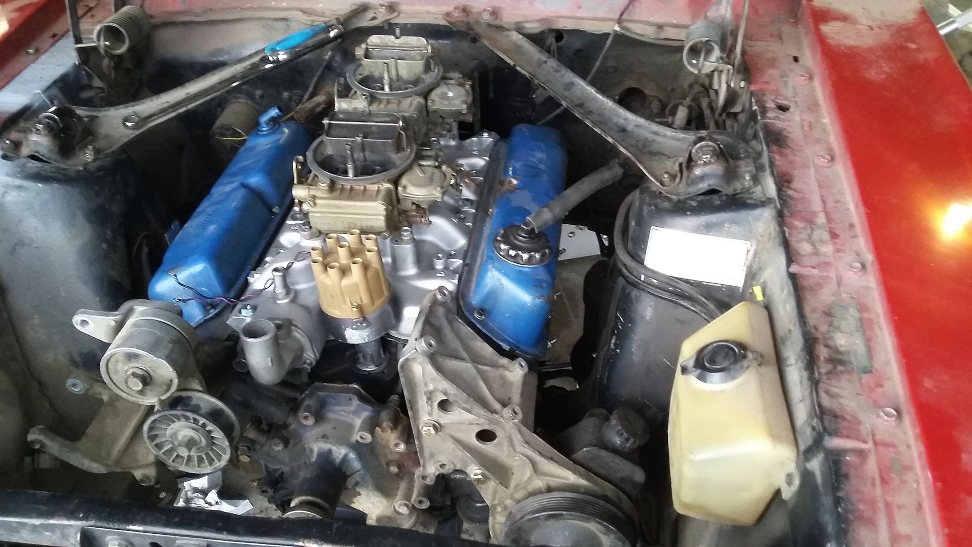

I like the mid 90s E150 brackets, you get the Saginaw PS pump, big alternator and a compact AC compressor, and these brackets are designed to work on 5.0 or 5.8 with only a belt length change. The last set I bought was $100 and included brackets, bolts, pulleys, and accessories (no water pump). Mocked up on a 68:
