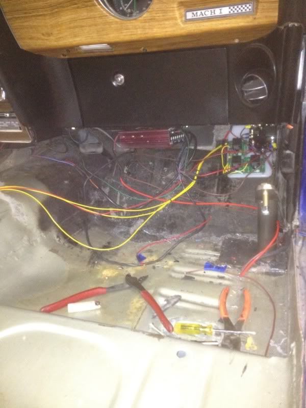

So, since I've got a driveline that's going to put up with some abuse now, I may as well go ahead and abuse it.
The plate and solenoids are mounted, along with the fuel pressure regulators.
I bought a module from a guy that simplifies wiring the transbrake and nitrous to all work together. Since the nitrous is on a WOT switch, it needs to not spray while I'm at the line on the Tbrake, and when I release the button, it has to release the brake, energize the nitrous/fuel solenoids, and retard the timing. It requires a few relays and a some thought. It also has to not retard the timing when the solenoids aren't activated, for motor passes. I'm still in the wiring phase, but it's coming along. It should be nice and clean when all finished.

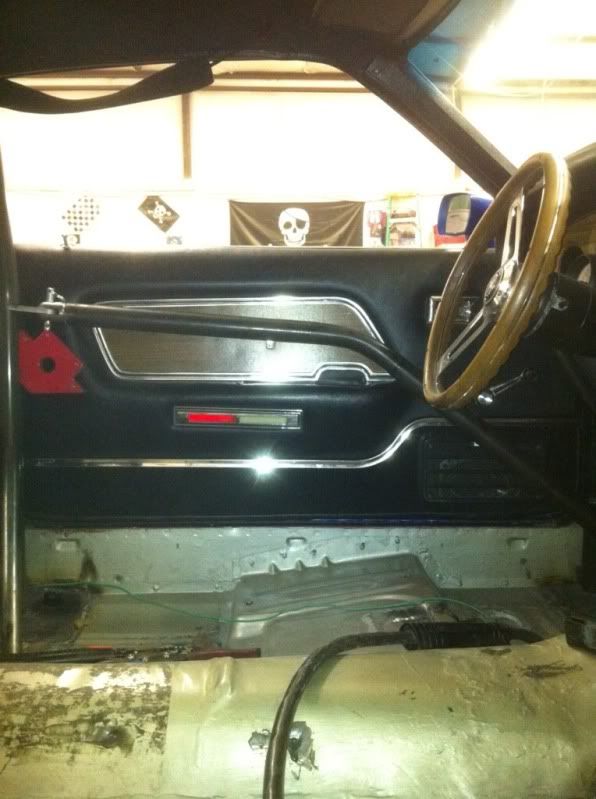

And since I got booted before, for not having a cage, and the car is obviously going to be a little quicker now, here is the solution.
Since this is still a street car (lol), the door bars are swingouts and they're also removable, so I can leave them out, until I go to the track. The crossbar is also removable, so my kids can ride in the back.
Now, even though the car is becoming heavily modded, I still want to keep it a modified stock style, so it's staying full interior. I'll still have the stock console, radio and all that junk. To stay true to it being a street car, I don't want a racing seat, but I need a 5 point harness. My solution was to have my stock seat modified to work, so to be as safe as possible, we took the cover off and welded multiple braces inside the frame to strengthen it. There is also a tab welded to it, so it can be attached to the crossbar, but the most noticeable change to it, is how I had it modified for the harness.
