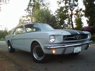

I have a 66' 289 in my 65 mustnag. its bored to a 292, balanced, 3/4 race cam, high compression pistons, 4 bolt main, high rise aluminum intake manifold and a 4v eldabrock 650 carb.
The heads are stock and not even rebuilt. The car isnt fast enough for me. With everything thats already done to the engine what did you think is the best way to go? Supercharger? Turbo? Nos? Suggestions plz.

Oh, BTW, nice hood on the coupe :pirate: Who makes it. i may need one for my '65 coupe.

Love the look of the car..Cowl hood looks mean!
