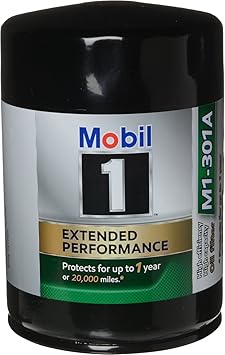

I like those filters too, but the Mobil 1 M1-301A Extended Performance Oil Filter is much better. They're a bit more expensive though.

I bought one of those mobile 1 filters then realized the bypass valve is at the back, meaning when it's in bypass mode trash can flow back into the motor. The Fl1a has the bypass at the beginning of the filter as specd by ford so that there's less chance of trash getting sent back into the motor when it's in bypass mode i.e cold starts or high revs. I've been buying my fl1a off rockauto when I have other things I need. They have them for 4.22 ea

another good filter, the one I use, is the Mobil 1 M-301.

I use the Mobil 1 M1-301 filter on my car based on some reviews I read on the Bob the Oil Guy web site.
Or just use a Mobil1 M1-301 or a Wix 51515XP filter which are designed for longer OCIs.
Don't just take my word for it...Please do your own research.
Mobil marketing states:
  • Contains synthetic fibers, which help promote clean oil - to support long engine life and performance
  • Removes more contaminants than conventional filters
  • Reduces resistance to oil flow while improving filter efficiency
  • Withstands up to 9X the normal system operating pressure

I trust the opinions of others too. I always assumed the M1-301A syffix is just a revision to the M1-301 (Mobil added the "A" designation to the end of the part number on the extended performance filters).
