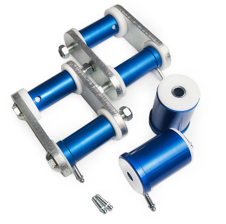

So, I picked up a set of Global West L-10R springs for my 66. I wanted to go ahead and put in the Del A Lum bushings in. But I'm loosing my mind trying to figure out which ones are correct.
When looking at the site, There is the 105SH, 106SH, and the 114SH.
114SH says for Reverse Eye Global West Springs, click the link, says it's for 67-73 Reverse Eye springs. And "This kit is for a reverse eye cat-5 mustang performance rear leaf spring. The difference between a cat-5 reverse eye leaf and standard reverse eye is the rear leaf spring eyelet dimension. The cat-5 is larger, it will measure approximately 1.625 inside dimension. A standard reverse eye rear leaf spring will measure approximately 1.350 inside dimension. The smaller bushing kit part number is a 105SH. Before ordering a Del-A-Lum shackle kit, please check your rear leaf spring eyelet dimension. " So, I assume I'm at the wrong spot.
105SH Says for OEM springs, which the L-10R are not. So, I'm at the wrong spot.
106SH says for Global West Springs, and says for a 66 mustang. I think I'm good?
The link for the L-10R says to use a 101SH, which global west does not sell.
I called Global West. The guy says you need the 114SH. I tell him what his website says, and he tells me they are referencing "standard" eye springs. I said, no it mentions reverse eye springs. I called back after discovering the link in the L-10R says 101SH. He says, he's never heard of those. But he's "pretty sure" it's the 114SH.
I don't have alot of confidence that this guy knows what he's talking about.
Is there a chart somewhere with dimensions of the bushings? Does anyone know what Del A Lum bushings are supposed to go in the L-10R springs?

Just waited on hold for an hour and got Doug. He clarified that his sales guy was wrong.
I need the 105SH according to him.

So, after calling 4 times and getting the same sales guy. I requested to speak to someone who knew what they were talking about, I got DOUG. I would suggest you do the same if you have any issues. Doug was great, and I'm pretty sure he's the guy you see in the Global West videos. His role in the company, I do not know... But he was very knowledgeable.
Doug explained to me that the Original L-10R Springs will use the 105SH. The "other" L-10R are the CAT 5 style that are designed to be used with a spherical bearing. They would use the 114SH. The 106SH is for 67 and up, or later made leaf springs. The 106SH were specifically designed for other aftermarket springs. He did say that some of the Global West springs may come in this size.
Take these dimensions as a grain of salt, as I was jotting them down as I was chatting.
105SH is 1.350"
106SH is 1.420"
114SH is 1.625"
After a long discussion with Doug and the misinformation on their website, it looks today as if they have attempted to rectify it on their site a bit better, I noticed some of the part numbers have been changed and are in BOLD on their product page. He agreed that the website was misleading and incorrect. And apologized for the other sales guys misdirection.

I called Open Tracker and they sell the 105SH and stock them. I was going to order direct from them, but I ultimately called Summit Racing and had them price match Global West's pricing and should have them in 2 days. I also get 90 days to return through Summit, so if something doesn't fit right... I can swap them for the 106SH.

I know. I'm tired of buying things twice for sure.
Decided to measure everything. Looks like mine are wrong.

According to global west, the fronts are all the same. You're gonna need the 105sh. I just got mine in today, I can mic them real quick if you need me to.
Yeah, fronts are the same. Was just curious. Got it figured out, they said I could just send back the one set of bushings and they would replace them with the correct 105SH.

Just an FYI- The 105SH does mic out at 1.380
