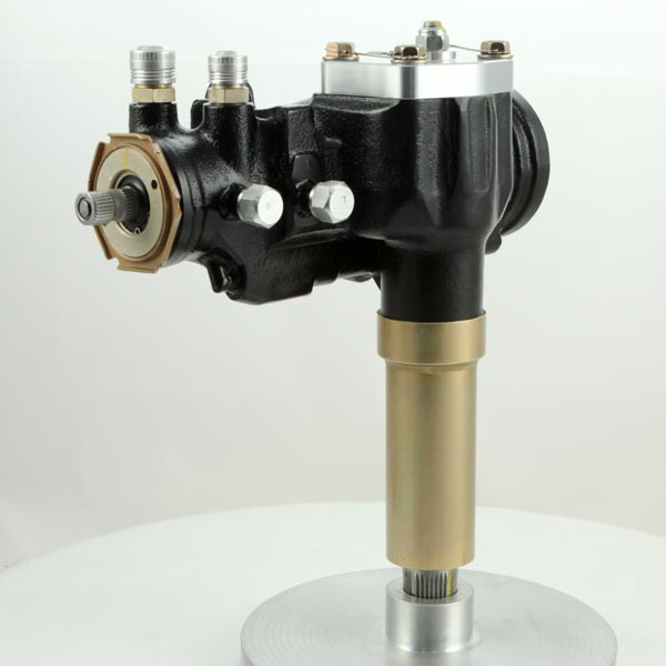

Oh, sorry - Q#2 - not sure. I'm installing a Borgeson P/S box and pump. Fits in the same space as the non-power box. The fluid pressure is applied inside the steering box - no cylinders and bunches of hoses. Pretty cool, methinks.

Seems to be a lot of people having issues with those boxes. Others love them. If I wanted to get away from the stock system I think I would go EPAS over Borgeson.
If you haven’t bought the Borgeson and are really set on one. Check out this. Borgenson power steering kit
