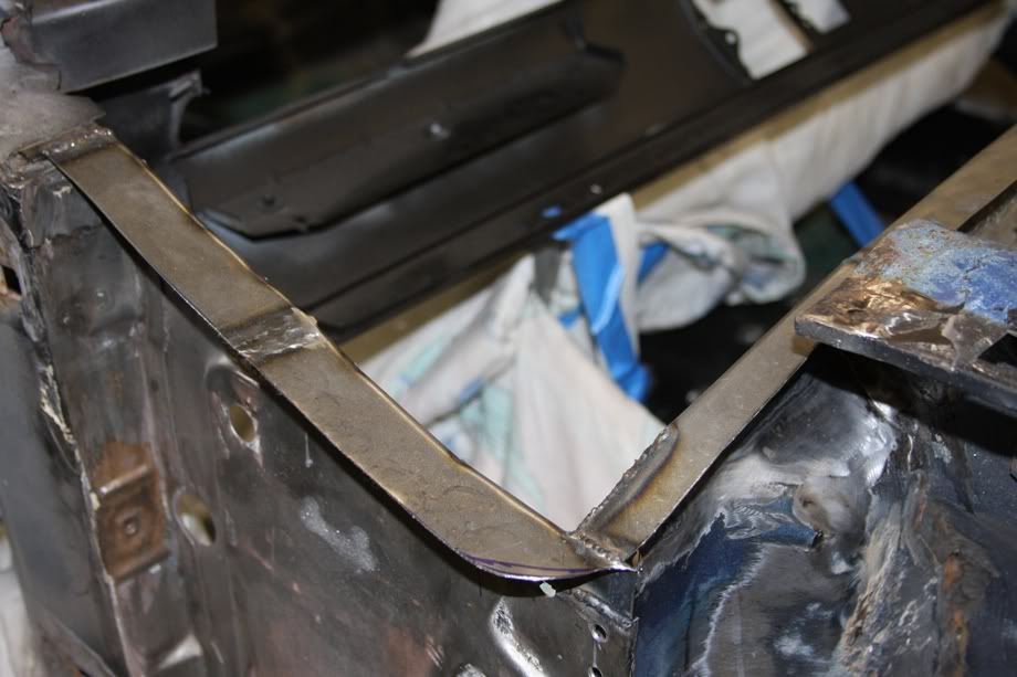

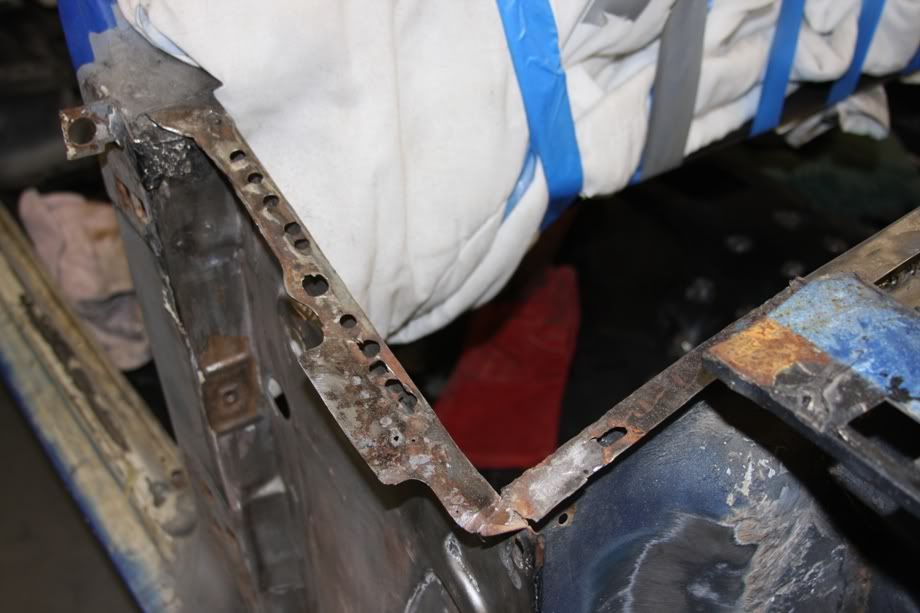

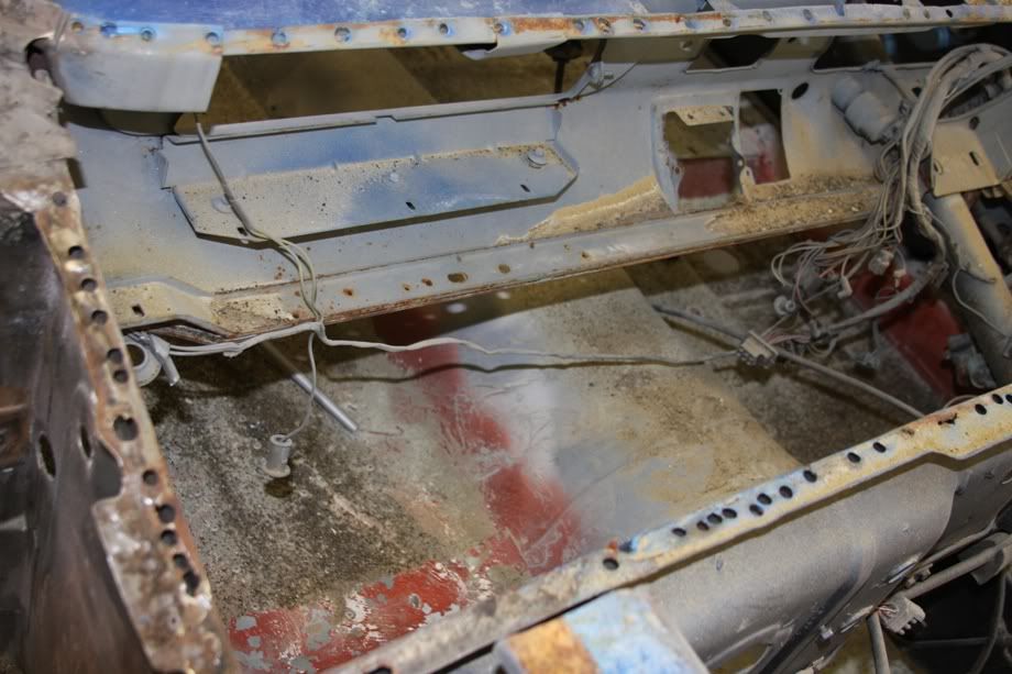

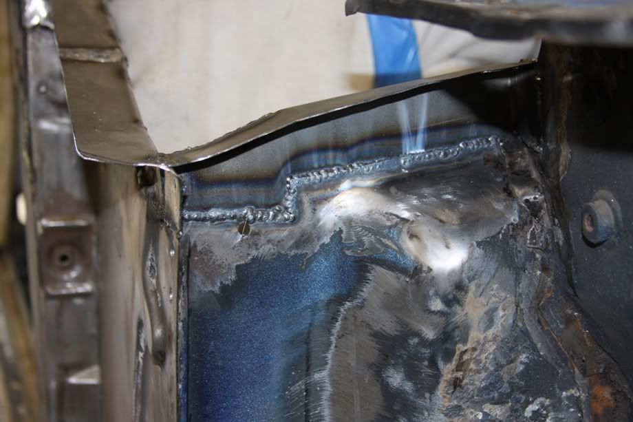

We are putting a full inner and outer cowl in the 65 coupe. The car really needed a firewall in it also, but we just replaced the toeboards, and rebuilt the top flange/reveal for the cowl.
I would like to paint the car, then do the wiring with the cowl out of the car (to make things easier to get to), then use panel bonding adhesive to install the inner and outer cowl panels.
Anyone done this? I know the adhesives are strong, but the only issue I see with using it in this particular area is that the the cowl is a structural component of unibody. The car does have subframe connectors on it, so that should take some pressure off the cowl.
