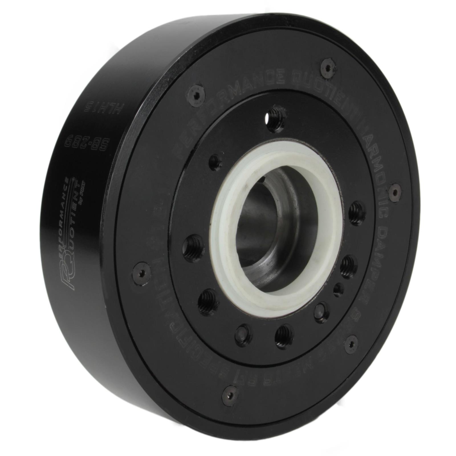

Ive read through online reviews, hard to say if the Scat harmonic damper is good or bad, virtually every balancer on summit has positive & negative reviewers to include the ones that come with Scats balanced kit. No one here used scat‘s kit provided flex plate and balancer…?
Maybe my next question then, what is a good street performance balancer that won’t break the bank or overkill…? And 3 bolt vs 4, arggh, more decisions.
Without knowing any better I would probably gravitate to ATI, but that’s overkill i think. I guess I have one more email to send to woody, I believe he sells a 4 bolt powerbond unit but the timing marks are a foxbody & 10-o’clock position. These do have pretty good reviews overall. But his part won’t work for my OE setup with rad & water pump connections on the passenger side.
I have had this one on my car since 2019. SFI rated
