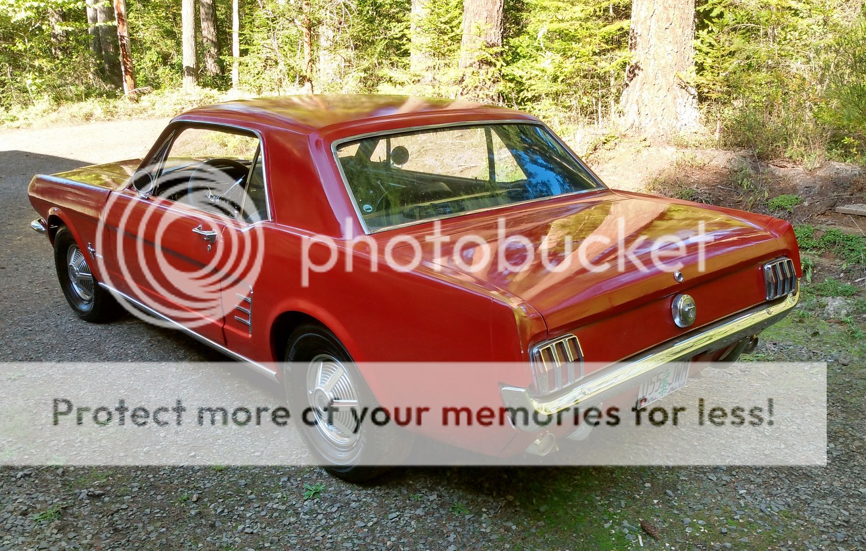

I realize it's heresy, but it's a real thing, it works, and for some of us it's a legit option.
I don't have the money for a paint booth job, even at Maaco. By the time I upgrade to their "decent" 2-stage I'm still in for upwards of $2k and I'll have overspray everywhere. And at that I'd have to do all the body work and prep myself.
My '66 was in bad shape from a very poorly done respray years ago. Cracking, chipping, and fading, never mind some body damage from the PO's encounter with a tree. I've got the ability to do some body work and the equipment for and experience with a 2-stage paint job. My avatar is a paint job I did 5 years ago. But 3 years ago we moved to the woods of western Oregon where my one stall garage has a dirt floor. Gravel driveway and 150' fir trees that drop sap, needles, and bugs.

Long story short, I got a very presentable paint job for under $250 not including body filler and some consumables. I can and will improve it with some wet sanding and buffing but it's a solid 10-footer. I could do better next time; there's a learning curve, esp. getting the paint/mineral spirits ratio right. But it looks a LOT better than it did for a price I could handle.
Oh, and Rustoleum Regal Red is so close to the original that if they're right next to each other you *might* notice a difference.

Looks good for $250.00! Another alternative for painting on a budget is the Duplicolor quarts that they sell at auto parts stores. Buy a $50.00 paint gun at Walmart and go to town ;) You'd be surprised at the results. The problem with Rustoleum is that is chips very easily. You will probably start to see rock chips on the front of the car very soon but, buy a couple of rattle cans and you are good to go again. $2000.00 for the cheapest Maaco paint job??
Yeah, I've got the gun, compressor, and all the pieces. But spraying anything but water out in the woods just isn't going to work. Way too much stuff in the air and falling from the trees. Never mind the bugs.
Yes, this will chip. But as you say, a rattle can in this stock color will take care of it quickly and easily. Also, I've got a small bottle of the mixed liquid and a foam brush ready to go.
Cheap paint does not stick very well and degrades quickly. If I were to do a cheap auto paint job, I would use an industrial enamel like Hy-Lux acrylic enamel. Reduce about 30% with acetone and add the catalyst. Roughly $50 a gallon plus 20 or 30 for the catalyst. Only comes in basic colors. Infinitely better than Rust O. Would have to be sprayed for a good finish. I am extremely well experienced with this sort of thing, so I do know what I am talking about.
Alkyd enamel and acrylic enamel spray and endure about the same for me. I forgot to say that I do add the enamel "hardener" when I use Rustoleum. Around I can find it at Tractor Supply Co., which also happens to have some budget-friendly enamel paints. Not so great color chopices.

The problem with Rustoleum (and enamels in general) is it doesn't have any UV inhibitors in it, so it will fade and chalk with time. If you limit time in the sun it will prolong the time until this effect happens. If you spray a clear coat on the car then it will be protected from UV and can still achieve a high gloss.
I spray tractors and implements with enamels because they're extremely durable, but even those I still clear coat to keep the gloss.

Again, not everyone can spray. I can't because of my setting in the woods even tho I have all the gear. To buy an adequate compressor, a decent gun with a couple of tips, cups....
And that outlay of $$$ is for a one-time project.
I spent $19 plus shipping (Amazon) for a quart, used three and could have done it with two if I had more experience.
UV rays aren't such a problem in western Oregon where we don't tan, we rust. But even if it does get chalky I hit it with some sandpaper and roll on another layer of Rustoleum. Total cost: $25.
