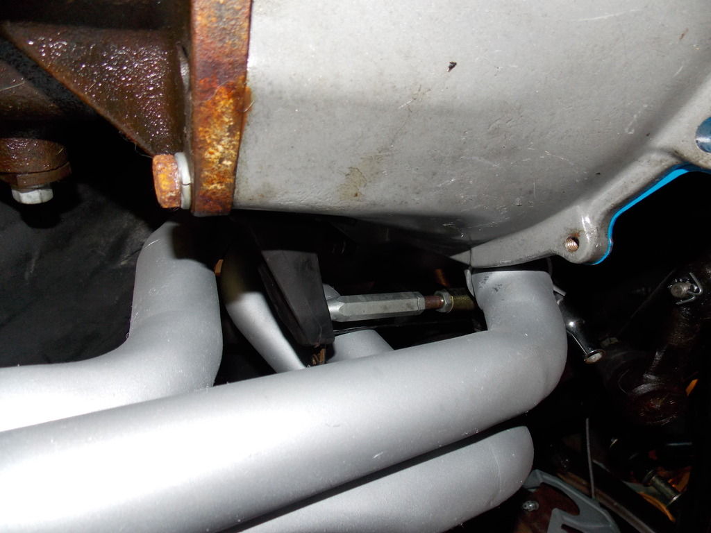

I don’t know if these pictures help. They’re MAC long tubes. Easy to install as #5 tube slips in. Great ground clearance, if you have PS, they’ll clear the ram without a drop bracket. They also work on GT40P heads. I’m running a 7 qt Canton pan, front sump.
