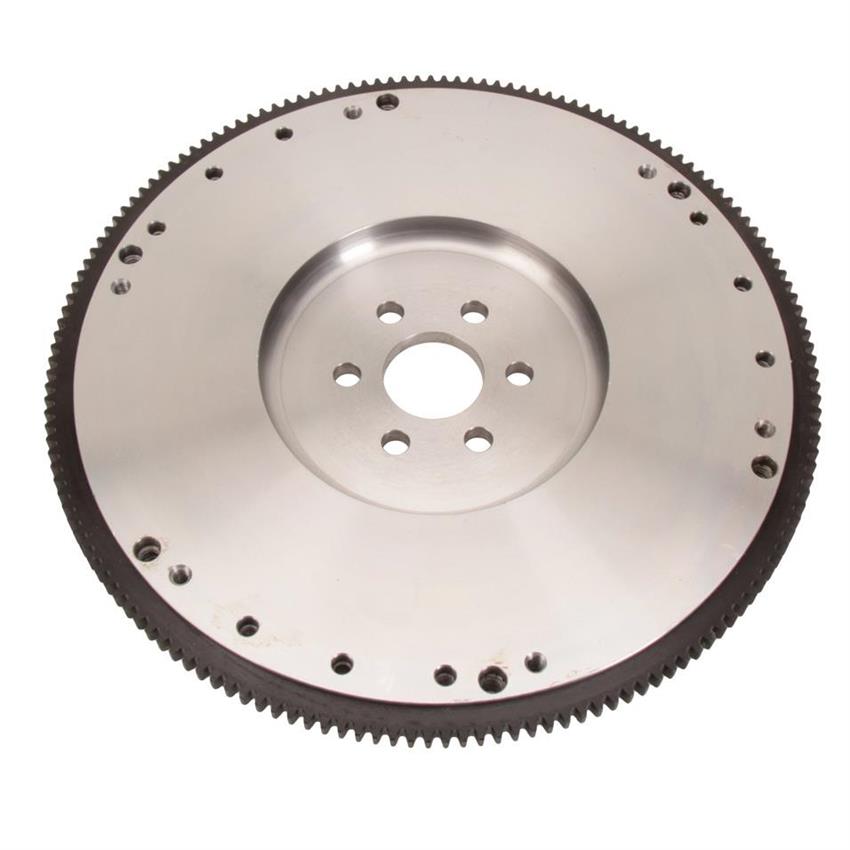

You'll also want a good Flywheel. I bought this one:
