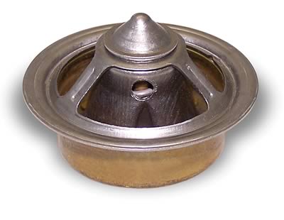

That's not overkill at all....Those are the ONLY thermostats that I ever use on ANY project. They were designed by Robertshaw many years ago and are called "Tri-Bar High Flow" Heavy Duty Thermostats. Mr. Gasket makes and sells them as well...They apparently bought the licensing to make them too.
