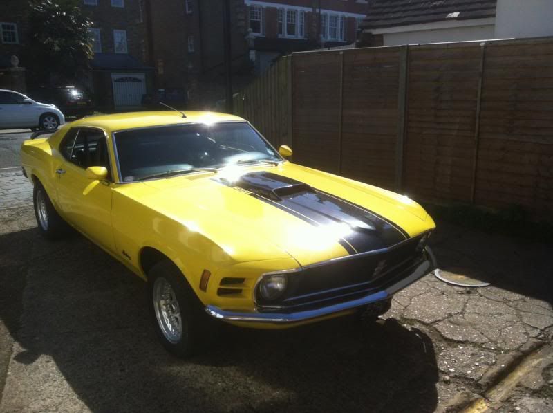

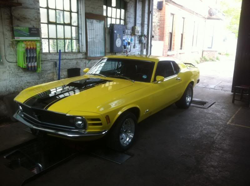

Would 235/60/15 fit ok on the fronts ?
I can get 225/60/15 or 235/60/15 for the fronts but I don't want it to sit higher at the front, any thoughts ? Pics below, thanks

Your rear tires are 25.4" tall.
225/60/15 is 25.6" tall and the 235/60/15 is 26.1" tall. They are taller than your rear tires, I don't think you would like how they look.
