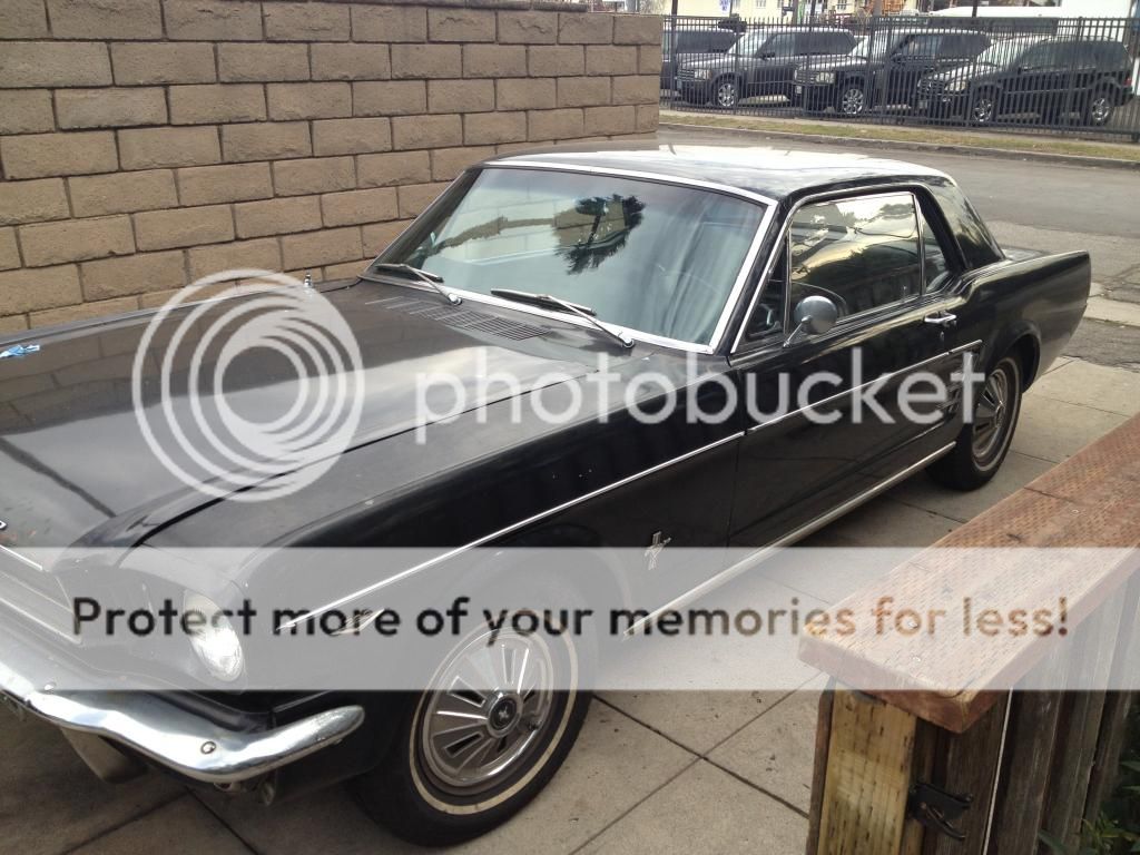

When I was looking for my Mustang a few months back not only did it need to be a solid 66 289 but I was willing to settle for only a handful of colors. I love the 60's hues and particularly the colors that are less common in a line up of Mustangs these days. Red, White and Black cars were of little interest in my hunt.
After about 6 weeks of looking I found an ad that was for a black car but it caught my eye because the seller stated in the advert 'originally metallic green'. Sauterne gold was one of my highly desired colors, and the car was local so I went and gave it the once over. 2 owner car. The women selling had had it as her first car since 74 and had bought it off her neighbor who was the original owner. It is a California car all it's life and still has the Santa Monica Ford dealer plate surround so it's now only 4 miles from where it was first purchased in 66.
The car is a super honest survivor and very solid and original. She had painted it a couple of years after getting it so seeing that the black paint, now 35 years old, has no blisters or ripples tells me it has zero body filler or rust under it. The original paint was still visible in the trunk and under the hood.

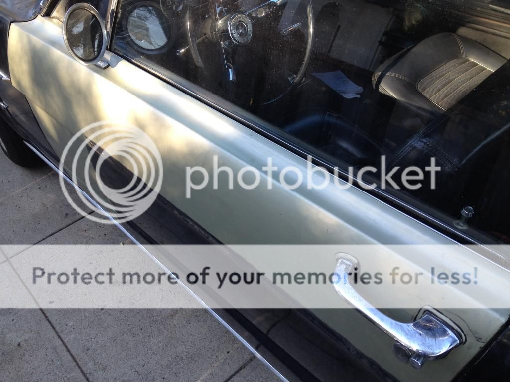

So I said I wanted an original paint car, and that's what I'm working towards. I know a few trick about revealing original paint and I started the work yesterday. With Graffitti remover, 000 steel wool and a lot of elbow grease I've uncovered half of the drivers door at this point. The original paint is coming back great. I'm rubbing through a couple of top coats and a thick layer of primer but luckily the paint underneath wasn't keyed too badly before it's respray.
I figure I've got about 100 hours of rubbing ahead of me to do the entire car- but I'm fine with that. I'm guessing a lot of guys on here might think I'm mad.
I would like to know how many other members have original factory paint cars and have no intension of ever covering it up?
Looks like they gave it a very quick once over with some kind of random orbital sander- but I'm able to buff the marks out as I remove the paint.
I've rubbed through and made 'exploratory' patches in most areas of the car and haven't found anything too concerning yet.

Also, it doesn't look like original paint around the door handle.
You are full of it. Wow. YOu don't see the difference between thinking you have original paint and it not being original?? That makes be a negative person? I'm just pointying out the obvious facts. I said I had an original paint car. Wow.
Think before you speak . . . . err. . learn.
Well sure, there is a chance the entire rest of the car is original. But I don't give a lot of credence to that based on the first panel he uncovered. So they painted the car door with the quality you get from a Maaco, but the rest is original? There is where the fallacy rides.
I hope he is enjoying his car. But I don't operate my life on false hopes and I try not to let others either. Is it time for another big group hug ???
From that picture of the door, I CAN absolutely say it is not original paint. I mean come on . . are you guys that confused about facts?
