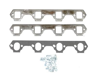

A somewhat reputable source told me that many (most?) SBF headers can be made to fit GT40P heads by adding a header flange and using it like a spacer. You know, the bare flanges used for custom fabbed headers like these:
Too good to be true? Maybe, but I’m interested in trying it out. I’ll report back if/when I do.
Anybody else heard this, or better yet, tried it?

I'm skeptical. The problem with typical headers is that several of the tubes bend right at the flange backwards. With the typical SBF head the plugs are laid back. The P plugs are more perpendicular getting in the way of the tube itself. The plugs stock out farther as well. The tube really needs to come pretty straight out for about the first inch before turning. A good rule is if you can get a deep socket on the rear bolt of each tube, you have a pretty good shot
Yeah I am too, but with the right headers, I can kinda see it working.
might work on an engine stand but spacing the headers out away from the head will cause shock tower clearance problems
Well, I get that it’s tight, but I’m not sure the thickness of a flange would be enough to kill the deal.

I would say it might work. On SOME cars and SOME headers. I had a GT40P on the stand for a while and tried all of my collection of headers, short, long, some for Foxes even, no. Borrowed some mid-lengths and another set from friends. No chance of fitting. Then like I don't enough enough junky headers around I bought some unknown long tubes reputedly from a "289 Mustang". Fit straight on. I would grind a little bit of flange for spark plug clearance but other than that, right on. Just going by my memory of when I was fiddling with various headers I believe that some could be spaced out effectively and on some it would be a waste of time. No hard and fast rule.

I am not sure I have seen hex head header bolts that would be long enough.
Seems like that should be a findable thing.
  • I doubt there is room in a 65-66 engine bay
I'm sure it depends on the headers, but there would be with my Hedman Shorties.
  • Fighting to slip one header gasket in can be a task, now two gaskets and a rigid spacer?
A pain, for sure, but maybe if you hold your tongue right.
  • Seems far more likely to leak
Maybe, but for the price difference I'd be willing to give it a shot.
I can say definitely, no, stacking a 2nd flange will not work. I had GTP heads and tried Hooker, Headman and Flowtechs. The plug runs right into the tube on a few cylinders. You could dimple some to work, but I seem to remember the #1 and #4 cylinders had a hard interference. There are headers out there that will work with little to no issues. MAC and FPA are two that come to mind as well as the factory cast iron manifolds with some help.
